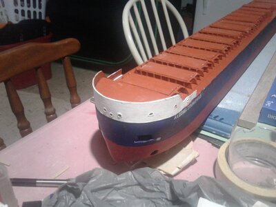

Here is my second lake freighter in progress before I found this site. The following is taken from boaternerd.com and gives a brief run down on this new class of bulk carrier. Picture is actually taken along the Detroit River where I live 2 blocks from.
The Algoma Central Corporation has been engaged in an ambitious fleet renewal program. The fleet has ordered five new ships capable of Great Lakes service and will manage two others of this Equinox Class for the Canadian Wheat Board. All are being built overseas in China.
Algoma Equinox is the first of the new Equinox Class of Great Lakes freighters built for the Algoma Central Corporation. It was constructed by Nantong Mingde Heavy Industries Stock Co. of Nantong City, China. The 740 foot long by 78 foot wide gearless bulk carrier was launched on December 24, 2012, and sailed for Canada on October 1, 2013.
This vessel, and its sister-ships, operate with a 45 percent improved energy efficiency and can carry 20 percent more cargo. It also has a much lower fuel consumption with the benefit of a 97 percent removal of sulphur oxide emissions. Highly automated, the ship can operate with as few as 18 sailors.
After crossing the Pacific and passing through the Panama Canal, Algoma Equinox loaded iron ore while inbound at Port Cartier, Quebec. The ship was upbound through the Seaway for the first time on December 3, 2013, and headed to Hamilton to unload at Arcelor Mittal (Dofasco). It then sailed to Superior, and loaded ore for Cliffs Natural Resources in Quebec City.
The ship spent its initial winter in Toronto and then received the top hat in a ceremony at Lock 3, St. Catharines, Ont., as the first ship of the 2014 navigation season to use the Welland Canal. After being part of the battle with late winter ice, Algoma Equinox headed to Lake Superior in convoy and with ice-breaker assistance. But as the ice melted, the ship soon settled in on the Seaway ore and grain trades and will hopefully be a regular trader on the inland seas for many years to come.

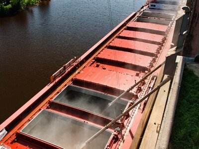

Here is the actual ship and am hoping to come up with a reasonable scale model...

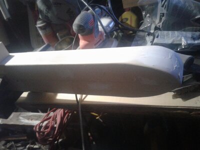

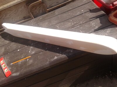

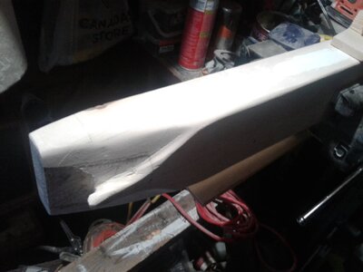

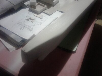

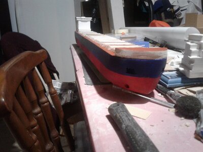

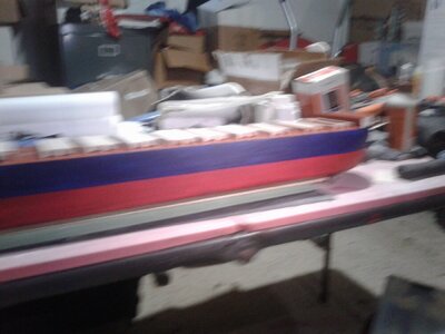

Used a solid block of basswood. I have shipyard drawings....no lines though so curvatures are all by best estimates based on drawings.

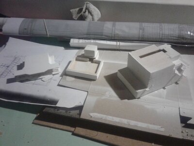

Accommodations and and deck are built one deck at a time from balsa to exact dimensions from general arrangements.
I've started assembly and prime and paint. Will be adding windows by hand.

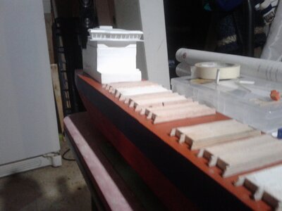

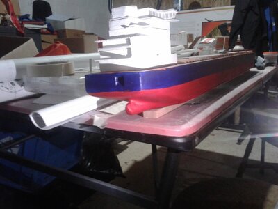

I am also a 1:200 scale as well. Fittings are going to be easier to find for this one. Here is the accommodations etc... plus the hull.

I have ordered some fittings and am waiting on them to arrive before i carry on much farther. Making sure my prop sits as it should is mystandstill point. Fittings for the 1:200 will be more readily available as its almost 1/16" = 1ft. Here are some of the fittings I have purchased previously.
I've been laying out the location of where the anchors will be and have hopefully fixed my prop bubble as well. I know the anchor locations look high but once bulwark is installed it will look better. Also been working on the accomodation decks as well as the navigation deck. I think I will stick with painting the windows as i have tinkered with using styrene however my skill and confidence are not quite there yet but ideally long term...this will be the proper way to go. That way you'd be able to see thru the windows?

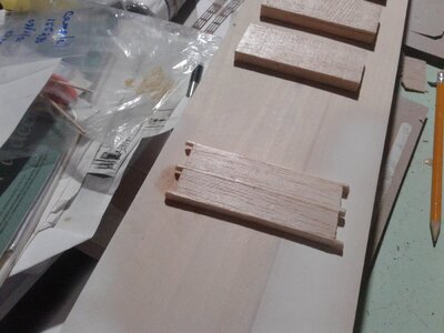

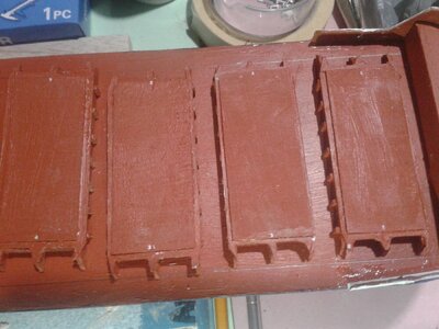

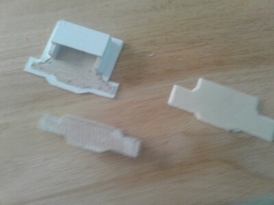

Haven't had much time to work on this but spent some time working on my hatches last week. Very complex but happy with how they are coming along. Might do one to look like it is open....
Made with balsa....the finlike supports are a pain....plus sone piping will have to go through them along each side if i want to go that detailed. See pic in 1st post.....or I can post a hatch detail pic.

Haven't worked on this in a while but had time to toy with the hatches. My wife suggested I leave one open so looks pretty good i think. Took way longer than i thought, but once fine tuned should be good. Picked a super complex ship for my first big build!
