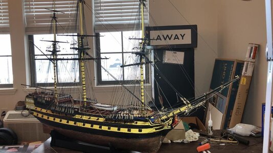

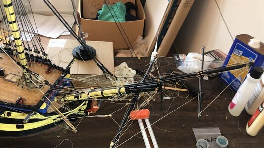

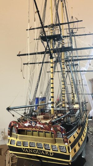

Enclosed is my first build, I should have kept a log but was too embarrassed that I wouldn’t finish it, but the end is in sight. I am struggling with the rigging a lot. Lines going through luber hole and rubbing up against edge of fighting deck, a straight shot would go through floor of fighting top. Also my knots/seizes are all coming undone., have resorted to superglue and very bad results with that.. anybody have a container/applicator for the 50% white glue,, hate making it fresh everyday….
