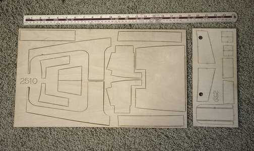

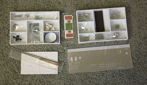

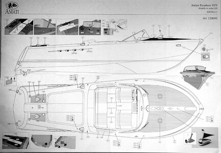

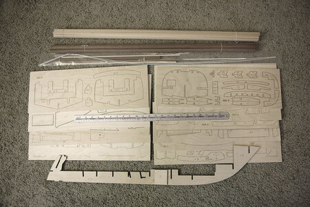

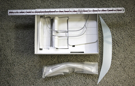

The kit comes with everything needed, it has five 1:1 plan sheets and a pictorial manual which gives very clear step by step instruction using excellent photographs, it misses nothing out even the most insignificant part is shown, it is easy to follow and seems to leave nothing in doubt. The wood is ply, lime and mahogany all of the very highest quality and beautifully cut, there is very little char to the laser cut ply, the holding tabs are only 1mm and are easy to cut away, this is I think the best wood offering that I have seen in any kit. There are a large amount of cast chromed fittings even an ignition key and nice sheet of photo etch silvered is included. The seats are a sort of rubbery molding, they used to be upholstered in fabric but when they got wet they were ruined so this type was introduced. There is also a sheet of textured vinyl for the cabin upholstery. All in all a well presented high quality kit that I can’t see how it could be improved upon.

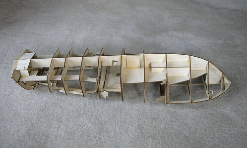

I’m afraid that I have already assembled most of the frame without showing detailed pictures. It went together so quick and easily that I just got carried away. I made up a simple holder for the keel out of scrap not very nice to look at but it did the job. I identified the ply parts from the 1:1 plans and numbered them before removing from the sheet, this was necessary as many of them were so similar with only such a slight difference between them that you could easily mistake them. The parts were very well cut with minimum char and they all matched the plan perfectly, it’s no good having nicely cut parts if they are not properly to shape as is often the case with kits. The ply used is very good, smooth close grain very hard and true. All but one of the bulkheads slotted in perfectly with no force needed but with just the right grip, one piece needed just a little sanding so as not to be too tight. Everything lined up and sat true and square without the need for any adjustment. I built it up putting in the gussets, bulkhead, edge pieces, floors, and reinforcements which there are quite a few of. It was like doing a three dimensional jigsaw, the fit of all the pieces was so good that I didn’t need to adjust any except where they needed to be angled. I was glad that I read through the very good instruction manual before I started as the cockpit area is not symmetrical and some of the parts would have fitted either way.
Well that’s the model under way, so far I’m very impressed with the kit and have confidence for the rest of the build. I can’t fault it so well done Amati.

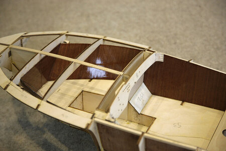

There is a day cabin with couches bellow the front deck, access is via the well in the floor, unless you’re determined you can’t really see into this cabin but there is the material to kit it out. The sides are lined in mahogany; the couches have cushions made from ply covered with the white vinyl supplied. I varnished the sides before fitting as once in it would have been difficult. I used this opportunity to try different varnishes and methods to see what finishes I could get, I found that after sealing them, yacht varnish was best, it gave the best depth look. It was a bit too hard and shiny a gloss for this scale so I found that by buffing it with TCUT, a buffing liquid for rubbing down car paint gave it just the amount of gloss that I wanted and at the same time removed dust marks from the surface.

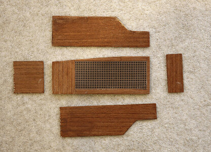

There is a ready made grating for the floor well, it was recommended that the well itself be stained, it didn’t look good so I made up from scrap mahogany a full lining.

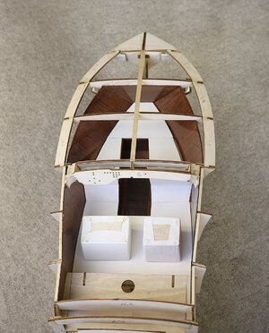

I made up and fitted the rest of the floor pieces.

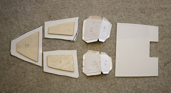

I made up and covered with vinyl the bases for the seats and all the fitted floor coverings.
The top outer edges of the bulkheads are not well supported; this is where the side planking will join the deck meaning that it would be just an edge to edge join, not good so I put lengths of balsa at their edge for good measure. Probably not needed but a belt and braces approach. I think that I’m now almost up to the start of the planking so watch this space and thanks for dropping in.
