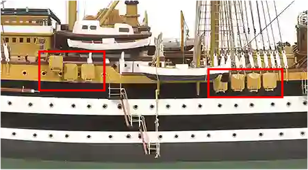

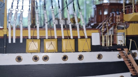

Hi, I know this thread is a couple of years old now but I have a question. I'm at the point where I'm adding the little square shaped things to the side of the ship. How did you attach them? The illustrations are not clear.
Hello
See picture below from my AV build (Mantua)
Does this help?
I used 8mm brass rod painted ochre and inserted into the hull
Hello
Does this help?
Thanks for the reply. Is that the brass rod that the line is attached to? On the Ocre model, some are attached at an angle and the rest looks like they're just glued to the side, but it's hard to tell. Even in Ocre's step by step videos the guy is shown making these but it doesn't show him mounting them. Btw, what are these things supposed to be?
