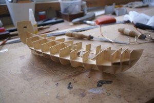

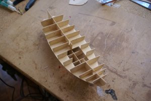

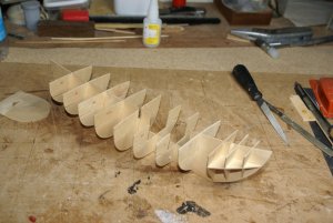

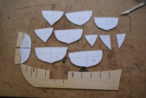

So, time for cutting patterns, scrall saw, 1,5mm ply, glue the patterns and let's see what comes out of that.
Tha band saw was very useful for all those slits necessary not only to join keel and bulkheads, but also the central centering pieces that give more rigidity and beat alignment to the whole.
Maybe I could have passes without those pieces, but working with so thin ply I opted for cutting and using them. My only concern was the alignment of all those pieces.
The first trials of joining the pieces was promising, it all fitted correctly.

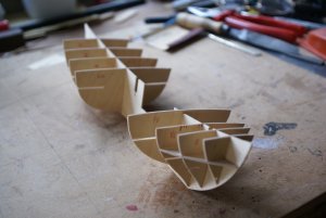

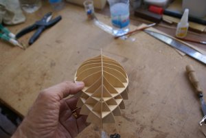

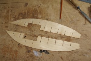

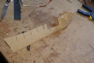

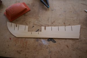

Next thing to be made was a central piece that, I suppose, is meant to keep the whole structure together and aligned. Being a piece with a lot of slits, my great concern was if the distances were correct and the pieces aligned perfectly. No need to worry, though.
Consisting of two symetric pieces, I tacked glue two pieces of 1,5mm ply together and shaped the thing. All withour any problems, except that shaping all those slits is a somewhat repetitive task.
And after separation:
So now I have a kit of pieces and it is the moment of truth, does the pieces align perfectly or did I get un impossible puzzle?
Well it fits. And perfectly, so the supplied drawings were correct.
DSC09311.JPG DSC09312.JPG DSC09313.JPG DSC09314.JPG DSC09315.JPG DSC09316.JPG DSC09317.JPG

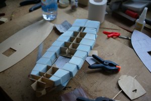

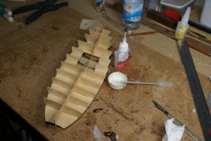

The structure was stiff and strong but needed to be fixed, so time for a bath of thin cyano.

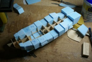

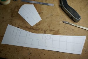

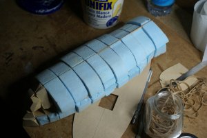

Next step, the deck. The wonder of the thing is that all the patterns are already made, suffice to cut them and glue them to some old card. Then You can use it to cut the ply.
Then, time to "foam" the thing.

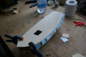

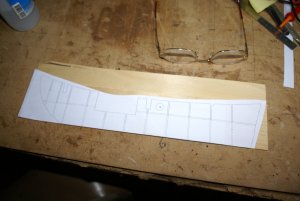

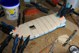

Time for the deck. The printed deck fits perfectly and it is a simple matter to copy it to 2mm lightply.
Since the deck has an accentuated double curvature I sanded the ply in order to make it more flexible. The position of the masts was marked in the deck.
Time to sand the foam to the deck level, an relatively easy task. The foam does not make much of a mess, since it is more air than material, but it tens to stick to the sandpaper and files. It is abrasive and the sandpaper needs to be replaced frequently because it gets soaked.
Just take your time and be careful and all goes well.
Checking the fit of the ply deck. Fits perfectly, the drawins are really acurate.

A pattern is supplied, so it was transfered to lightply.

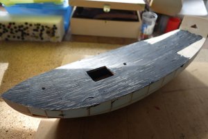

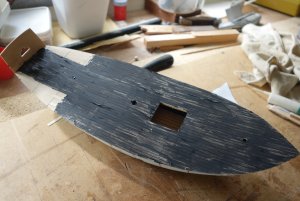

It is not shown in the plans but I decided to build a space around the lower deck in order to avoid the foam and the structure to be seen. Painted in black is is virtually invisible.

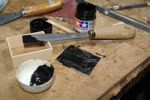

The lower deck was planked with some scrap wood from the "Prince" and I simulated some treenails.
The it was time for the black glue (PVA plus black acrylic) and it was spread over the lower deck with a spatula to force the mixture into the spaces, as I had already tried on the Prince of Newchâtel.
After some sanding I was pleased with the result.
Just to see if it fits:
And permanently in place and with the sides painted in black acrylic.

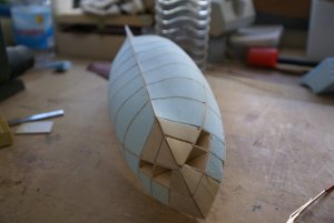

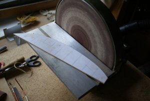

Well. after I got the ship in the shape of a mummy, I had to take care of the bow. For this I choose Obechi (smaba or ayous), since the planks tends to exerce more pressure here due to the curve and I'd rather have a strong bond. It was a hell of a job to sand it, if it weren't for an help from the disk sander it would have take much more time.
Time to get the deck in place
and sand the whole thing to get a nice ship shape.
Next step it to plank the deck, but with 3mm planks this is going to take some time...

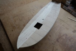

Back after a short holidays abroad.

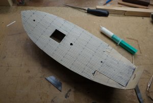

Work goes on, I am planking the deck with 3mm tile planks. Being 3mm it means a slow, tedious work.
The stern castle is going to cover a large part of the stern, so no bother planking there.
It is exciting to see a "paper" ship take form in wood.
