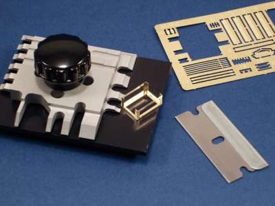

Generally speaking the majority of photoech material for scale models comes in thicknesses of 0.2mm ~0.3mm. Such thin materials don't require annealing for further bending. Also, some of the manufacturers photoetched patterns for easy bending. In case you don't have such a pattern, you can score them with a sharp awl point or knife.
Annealing the fret or just part will bend it so it will be difficult to flatten it again. Also, it will oxidize it and will make it difficult to clean up.
I've used in the past PE bending tools for complex bending tasks and they worked well, you just need to follow the proper order of bending parts.
