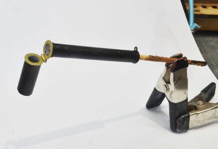

I started work on Piroscaf's Steam Cutter, which arrived last week and have come up with a problem when annealing the photo etched parts. Being new to this type of work, I read the threads on the topic in SoS, I heated the sheets till they glowed red and then air cooled them. The problem I have is that the photo etched sheets now have changed from copper/brass(?) to a very faint pinkish rainbow coppery colouring! Is this what should happen or should I now clean the surface, and if so, what with?
I also tried soldering two parts together, but the solder will not flow into the joint, but stick together using CA (Super Glue).
Suggestions and advice will be very welcome.
