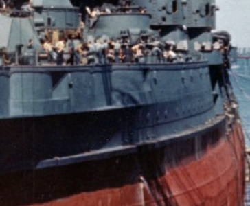

Doing my research, I have noted large almost cast port hulls on both Arizona and Pennsylvania;
Appreciate this is Pennsylvania with the Port Holes blocked out for Wartime Service...

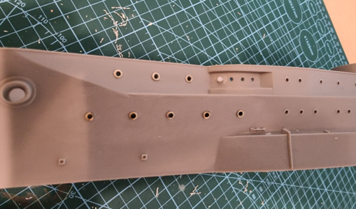

The issue I found with my kit is with any moulded kit, holes on angle faces become elongated.
So, I found some Micro Eyelets at 1.5mm internal Diameter and 2mm External and after countersinking the hull;
So, your honest opinion all, is this too much?

Maybe there is chance to flatten the rings?
when we take a look at the lower group:
- the five on the left side are looking much more dominant like the five on the right side (which are looking more realistiv in my opinion
Ah,
The reason for the prominent bottom row is because I wanted to point the Portholes out to sea rather than down onto the Ocean with the angle of the bow...
Have I done this incorrectly?

Love the look, they work well. I have been searching for those "micro eyelets" for ages. Can you say where you got them. I too am in the UK

Must be something with guys called 'Steve'. I too am currently working the 1/200 Titanic and have the Arizona partially constructed but on hold whilst I work my Titanic. Have build logs on both, so would be keen to follow your build on this beauty, as well as your Titanic once you get underway. On the portholes, and this is just me personally, the only thing 'wrong' is the eyelets appear out of scale with the rest of the moulded ports. May look totally different when painted of course.

The Portholes should be flat to the hull face, even if it slopes downward.I wonder if you may be better gluing styrene rod into the holes, sanding flush and drilling a new porthole that is true.
If you are doing this as a learning curve, don't overly research Arizona,I have seen one build of this kit where half the hull had been cut apart to make the shape accurate.
