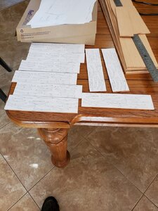

i have been getting some tools and things together for my HMS blandford build , i had the plans printed at my local kinko's and i am trying to source some wood , looking at the plans , and reading some of the build logs i know that i need to check the measurements of the prints, so my first question is , how?
i had the base printed on 11 x 17 paper and i found some measurements in a build log but mine aren't the same , how do i know what is right?
When you go to a printing store, it is VERY important that they print to “actual size” and not “fit to paper”. This can cause a lot of bad problems. There should be a scale at bottom of plans for the jig. I assume you are talking about the jig, right?
Hi Anthony, welcome to the group, as Donnie said the drawings need to be printed actual size when printed, if they were all printed at the same time on the same printer, they will be fine for the exercise.
The drawings sets are available at two different scales, 1:48 and 1:32 you may have been looking at drawing at a different scale than yours in the log you were looking at.

actually i think it was your log that i was looking at and at some point you gave measurements from the outside of former 1 to the outside of former 9 and it is different to what i was getting, i printed the 8.5 x 11 on my laser printer at work ,actual size not fit to page and the larger prints were from kinko's , the scales on the bottom of each drawing are exactly 2 inches , so everything should be ok ? also the measurement of the plank that the formers are cut out from measure what it says on the page 8 x 2 i think.
i printed both sets of 11 x 17 drawings at kinkos and asked them to be printed at 100% i also assume this is ok . i wasn't and am still not 100% sure which scale i want to do but leaning heavily to 1:48
so i held the drawing of the base and one of the deck up to the light one on top of the other and they match , so again , i'm assuming that everything should be ok
After the prototype was built I made several revisions to the drawings, you may have seen an old dimension that has been revised. The drawings you downloaded are the latest and most accurate. They should be ok.
Mike

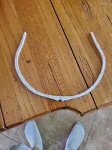

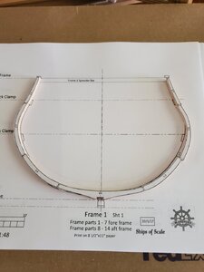

i wanted to see if i was able to cut out the frame parts so as a test i cut the first one , it didn't take too long and i think it came out ok , my next hurdle is going to be sanding the inside of the frame , any suggestions on what to use?20200725_161225.jpg20200725_161230.jpg
