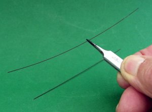

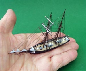

The thread\rigging specifically is here. The really big advantage of this material is that it will stretch, not break if accidental pressure is applied to the rigging on the completed model.
They now have 3 different sizes to choose from, which is: Standard: 0,03mm, Fine: 0,02mm, Superfine: 0,01mm

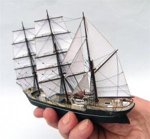

  • ->Standard is your trusty friend on your 32nd and 48th scale rigging.
  • ->Fine is considerably thinner and the stuff that fits when it comes to controlling cables in the 32nd and 48th scale, for instance.
  • ->Superfine is pretty much spider web and will look supercool on your 72nd scale project. It is like on the real thing: actually you won't notice a rigging before you are pretty close to the aircraft.

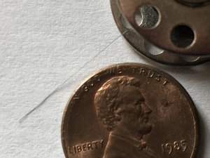

This is 0.01mm example
Hope this will help. Happy Modelling!

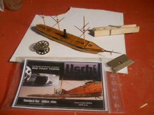

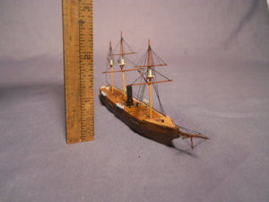

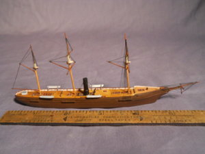

Finally got the rigging started. The elastic rigging stuff seems to work ok so far. It is very small but grabs almost instantly with super glue, it was used for the first set of shrouds, the rest is streached plastic sprue. This project started out as a basic design but has gotten a little more involved than was intended. It has its flaws (the davits could have been made with smaller wire that I found later) but is working out as a good learning experience in small modelling.DSCN0775.JPGDSCN0780.JPG
