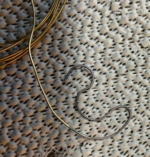

For darkening brass I use diluted selenious acid solution (!!poisonous use mask!!).The surface of the brass part should be clean (not coated by lacquer or vernis ). You can remove it by using a solvent or by sanding 800 -1200 with sand paper.
Application: Put the brass article for appr. 20-30 seconds while shaking .Take it out and rub with a piece of cloth then treat it again with the same solution for another 30 to 60 seconds.The end result is in the attachment.
I bought the product from a shop who delivered all kind of articles also chemicals to bras working sector producing like bed frames ,antique looking table lamps etc. Kind Regards
