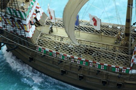

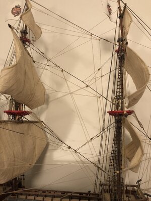

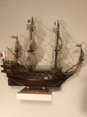

Thank you for your kind words. I have to say that I 'am not acquainted with maritime definitions and meanings - and in English! - except for some basic terms. So I had to look up what is a "spar deck" and as far as I understand it, it is a smaller deck above the main deck from stern to stem. Now with respect to the nets attached to the sides of the spar deck the kit - as I recall it - did not contain any information on its purpose! I assumed it was a kind of protection (not canons!) for seamen when in battle? I 'am not sure, but I think I have seen something like this on Nelsons "Victoria"....
I hope this is a satisfactory explanation but if you have a more correct idea, I 'will be glad to hear it

No worries. This hobby has taught me to learn maritime terms not only in English, my native language, but also in Italian and German because many of books I used are in different languages. The hardest to translate with Google is Russian. Their expressions are often indirect, and to not translate well into English.

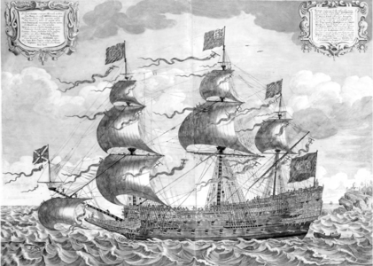

A spar deck is a temporary deck made up of spars (light wooden beams) and grating. During times of combat, it stretches across the top of the waist of the ship, from the forecastle to the quarterdeck. It is used to prevent enemy boarding, and also an easy means of walking from the stern to the bow by the crew. Under normal sailing, and when cargo needs to be loaded through the hatches, it is dismantled. The spar deck was rarely used after the mid 17th century, since boarding actions were no longer the main focus of naval combat and guns grew much more powerful. On your model, the netting could be stretched over the spars and make it more difficult for boarders. Perhaps it was also strong enough to walk upon. Most model makers do not show the spar deck in place because it blocks your view of the waist and the the weather deck. Also, it is hard to install once the rigging is completed.

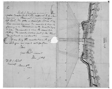

You can see people walking across the spar deck, high above the waist, in Payne's engraving of HMS Sovereign of the Seas below.
Thank You for your very informative answer! - Suddenly my model made much more sense!

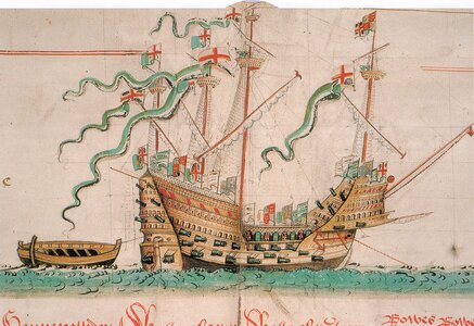

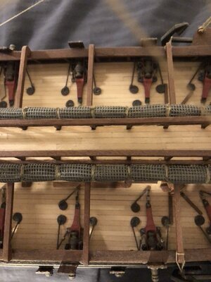

Short explanation to the nets:
These were anti-boarding nets at this time of Navy
Jim Baumann made once a great model of the Mary Rose in 1:400 showing them on his carrack

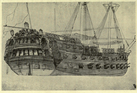

Later on nets were also installed over the deck against shrouds as a protection against debris falling down dirung action
