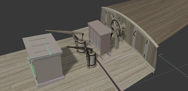

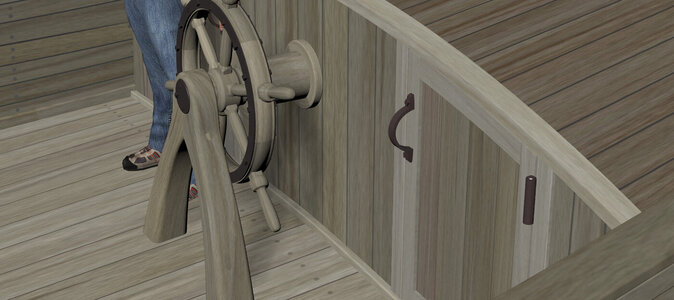

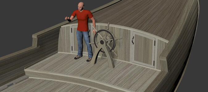

The door handle and hinge, in my model so far, are the way they appear in the book, instructions sheets and builds I have found, but it seems like there would be a latch of some sort

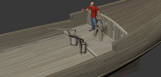

I have taken a little artistic license on a couple other areas in this screen shot
The standing guy is to show scale, I know he isn’t very 1800th century
Thanks

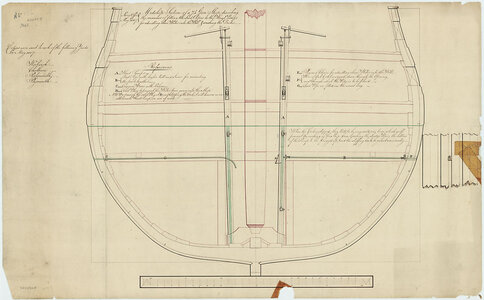

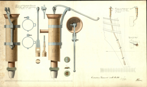

That is a nice drawing, the Danish, upper one with the details, what is that from?

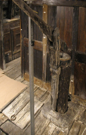

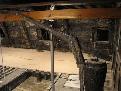

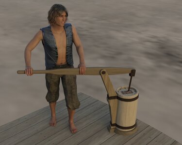

I made the height and diameter of the log using the dimensions given in the book Modeling an Armed Virginia Sloop of 1768 I might have to leave the diameter as is, otherwise I would probably need to remake everything, I will look at it
I hadn’t made the spout yet, I forgot to do it before posting the screen grabs
In the book mentioned above, he says to make the spout a 3” (full size) (7.8 CM) square
What would hold the spout in? just press fit?

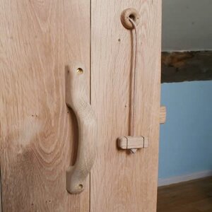

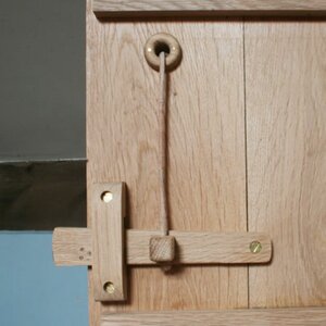

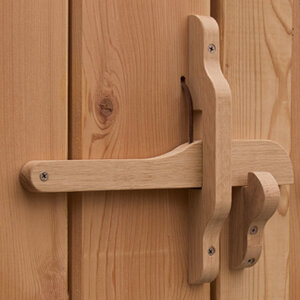

Thanks! I found similar in metal, the lower on you could also open from the inside if it had a notch through or a shaft on the pivot
But in the end, I sort of ignored this and just copied the ones from the model I was remaking
