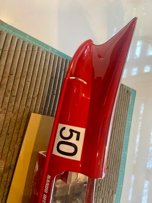

The Amati kit comes in two variants. One is the classic which requires the building of the hull using cross sections and double planking. The second versions, which I have, comes with the prebuilt hull in fibreglass already planked in mahogany.
being my first boat build I opted for the second version. Also, I wanted to spend more time on the other details.
The kit does not come with an engine, and the body shell is one fixed piece.

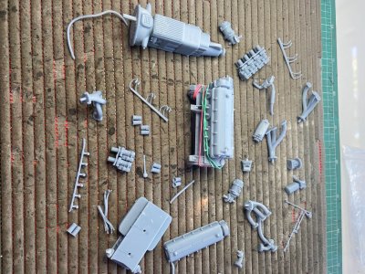

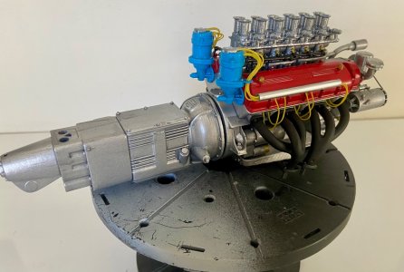

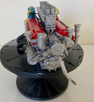

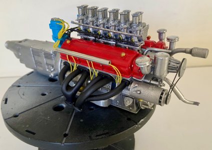

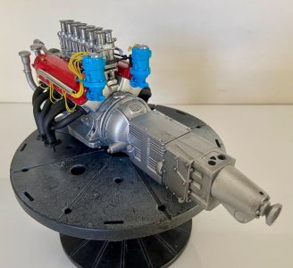

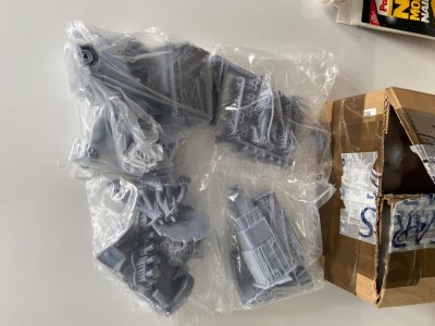

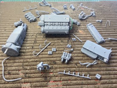

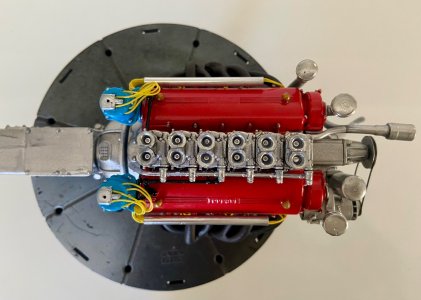

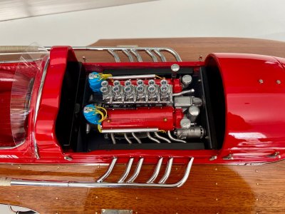

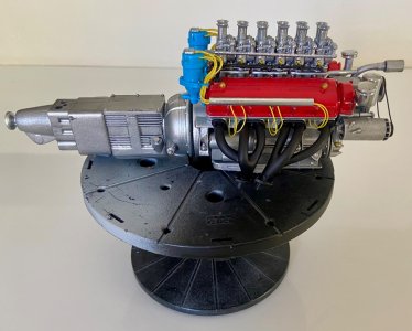

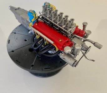

I have a 3D printed engine in 1/8 scale, so will cut open the body shell and install the built engine.
Sadly, no one makes a model of the Lampredi engine, so I am cheating a bit by installing the Colombo engine. But its a Ferrari engine, so thats all good :cool:

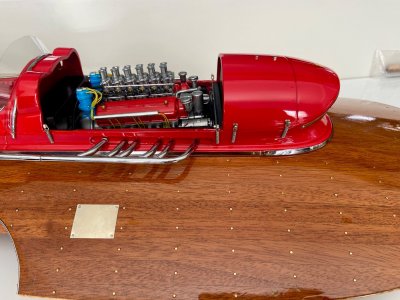

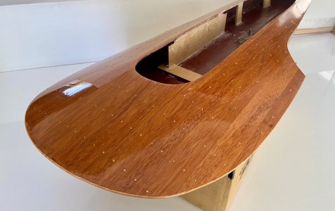

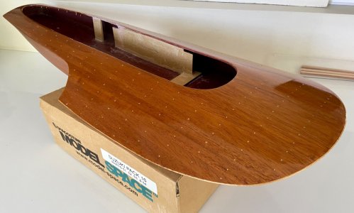

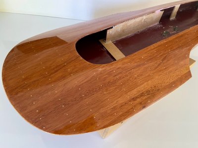

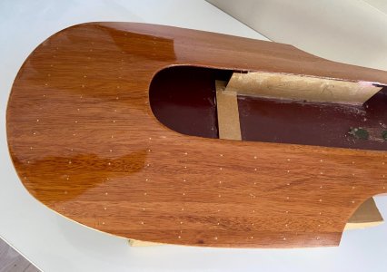

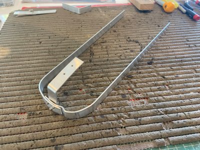

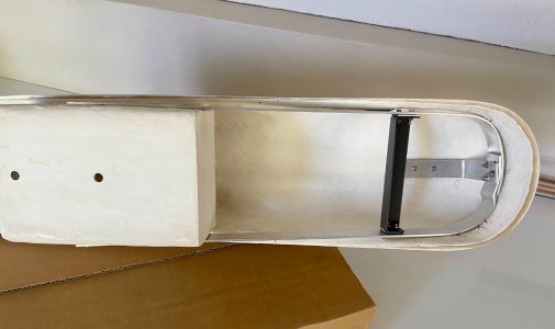

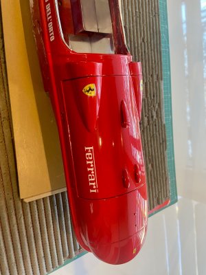

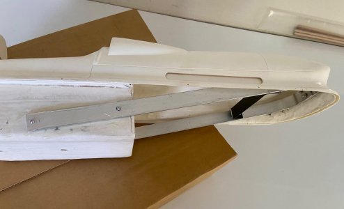

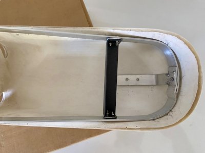

The first step in the build was to reshape the top of the hull to ensure a good fit with the body shell.IMG_8696.jpeg
The hull as it comes prebuilt has several gaps between it and the body shell, so I buttressed the inside of the hull to raise sections of it and ensure no panel gaps when the body shell is installed. Fortunately, the edges of the hull are somewhat flexible os this was not too demanding...

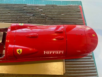

Once I was satisfied with the fit of the body shell on the hull, I got to work on installing the brass pins.
Here I discovered that having a fibreglass hull, while great for saving time and effort with building the hull from scratch, actually has one key limitation.
The brass pins are simply too soft to hammer in on their own accord, so I had to mark and drill all the holes individually.
Even then it was a challenge as the drill bits supplied with the kit and just that bit (!) too big for the brass pins, so after having drilled the holes, I had to dip each pin in Ca glue and install into the holes.
Lots of effort and fuss but the end result is great.
Still loads more holes to drill and pins to install...

Alan, being a mainly Pocher guy I have or have had over 50 of the kits, including several Testarossas, and the Testarossa engine only kit. But that engine is not suited sizewise for the Arno Bodyshell, hence I went for the Colombo engine instead.
