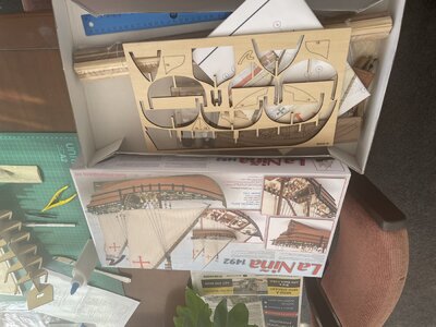

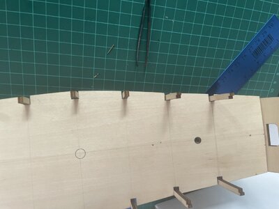

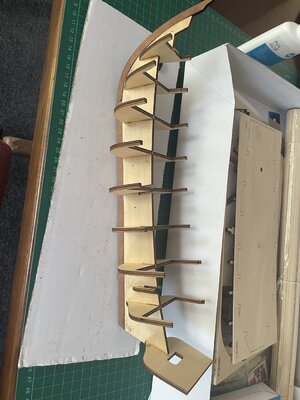

Hi. This is my first build and I was posting in the introduction forum. I thought as I am taking photos and doing a build I may as well put some stuff in here. I have started with some photos of the build so far and will add notes as we go. Lessons I have learnt so Farr are:
These things aren’t cheap
Read the instructions and research the sites before getting started

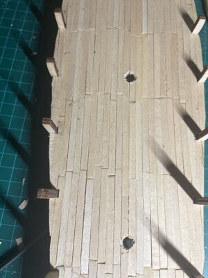

Do planking on decks etc before attaching them to the model.
This is addictive.

Those are valid things you list as things you have learned. I will point out one thing about planking the deck prior to mounting them-this will vary model to model. For example the Compestela I am working on does not have a separate sub-deck that the planking is glued to. The planks are mounted directly to the bulkheads one at a time just like on the hull.

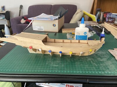

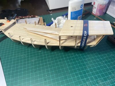

Last night I put the poop deck (Bridge deck) and bows on. Had to do a little snding and adjustments to make them fit, and I found hosting the America's Cup was worth it as the rear bridge deck is held on by a bracelet they handed out at the Auckland Viaduct when we went there. Today is all about starting the planking of the hull and I am putting this off as much as possible as I am nervous - hoping the fairing has been done ok and expecting it to be quite frustrating at times. I am thinking of using my wife's hairdryer to heat the planks after soaking to help with bending them. I note Glenn - you put them in hot water. What are people's thoughts and suggestions Please?

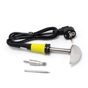

Maybe for the future you could think about the buy a such an iron - because the steam is important, which is produced with the contact of the hot iron with the soaked plank

In my experience, the thing is not bad, but with the large attachment, it takes forever to warm up.

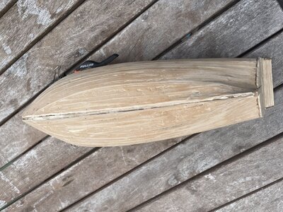

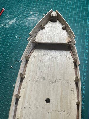

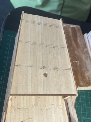

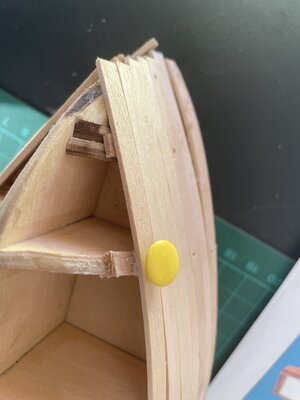

Planking has started and I have already realised that sanding down the forward deck was needed before putting the first plank on (Doh!) but otherwise seems to be going ok, just slow.

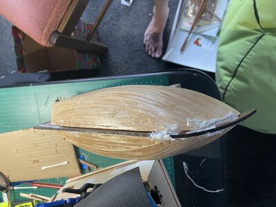

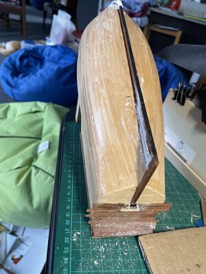

So started planking the hull last weekend. A Very slow process as having to wait for the glue to dry before going on to the next one and only able to do two at a time. The pins work ok but I think the fairing needs some work on the next one!

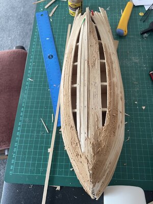

Anyway, I am using the electric jug (kettle) and boil it with the planking in the water then hold it in the steam. This I found worked well.

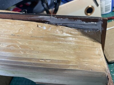

The planking was a bit off in a few places so I am using wood filler to fill in some of the defects, gaps, dips and other disasters. Otherwise it is really nice seeing it come together.

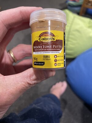

looking good to me. If you don't mind me asking, what wood filler did you use ?
Hi there. I used Cabot’s wood tone putty. $13 from Bunnings. Need to sand it tomorrow and see how it goes. Then clear varnish over the top (pva sticks to it as is water based).

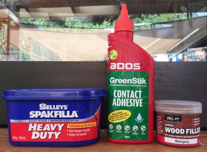

Hutch, my apologies for the tardy reply. photo of the products I used on my build. Spakfiller for the first planking gaps, Greenstik for the second planking and PAL to fill the odd gap on the second planking especially around the bow area. All products water based from Bunnings.
Hi ConsNZ. Thanks for this. It is really helpful. I think another trip to Bunnings is coming up.

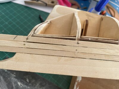

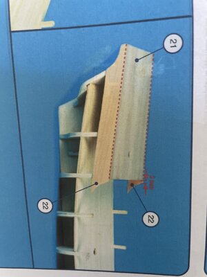

So yesterday I attached the sheer to the bow using 3 batons. I found the best way to do it was to place the first one and let it dry while gluing the other 2 together separately after making sure they were bowed to fit.
I used PVA on the sides of the Barton’s as there was only 1.5mm surface to glue on to.

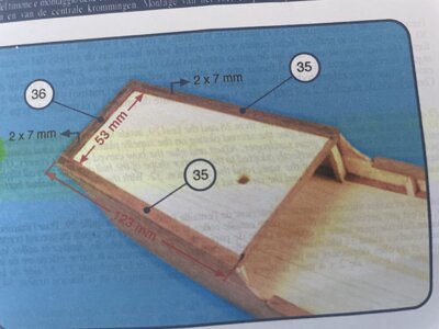

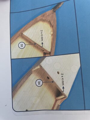

Then I skipped ahead to placing the bow and stern ends. I was going to put the side gunwale covers on but then realised I had stuffed up
I misread the instructions that stated set the bridgehead bulwarks but did them 3mm higher than the bridge deck. Hence I now need to trim them down to place the gunwale covers!
Oh the joys of not reading the instructions properly.
