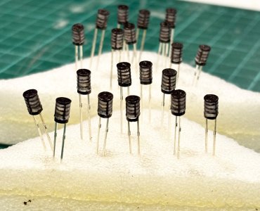

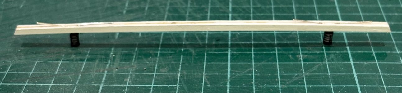

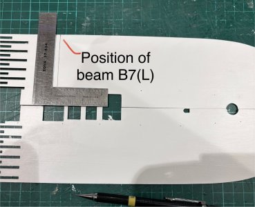

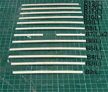

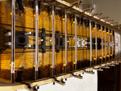

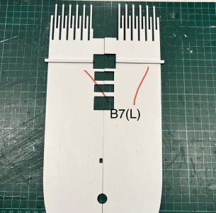

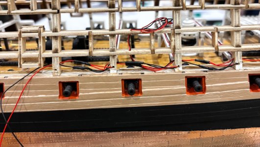

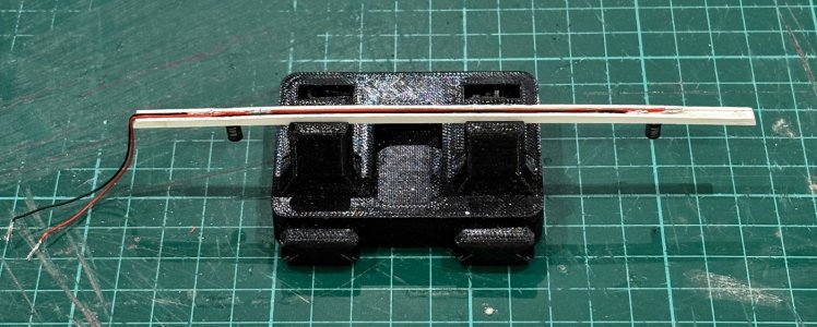

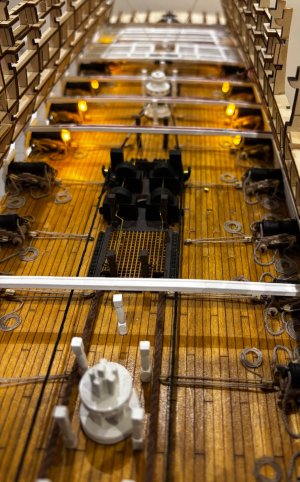

After a nice holiday break I resume the build. In video #26 I prepare and paint the beams that support the middle gun deck and install the LED lanterns, using the groove created to lay the wiring into. Connect all the wiring and test LED’s. Finally in this video I use cut down pieces of WS3 wood strip, painted white to infill the spaces between the beams up to their top level. Note : Beam #7 is not fitted at this stage

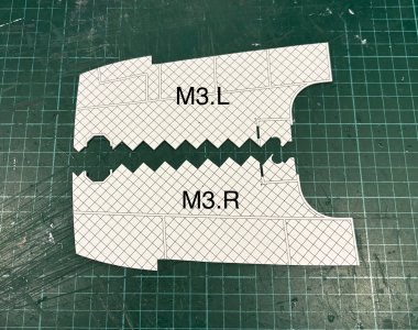

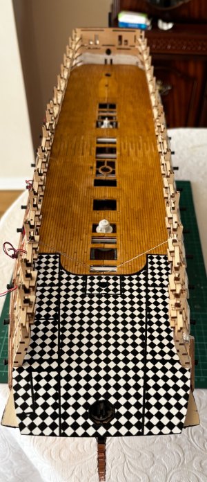

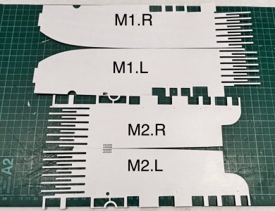

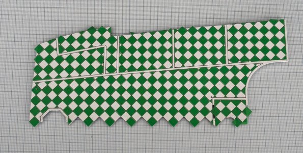

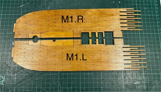

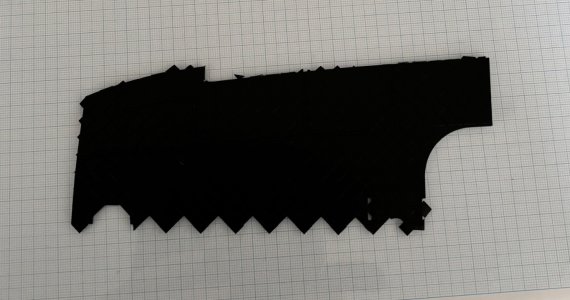

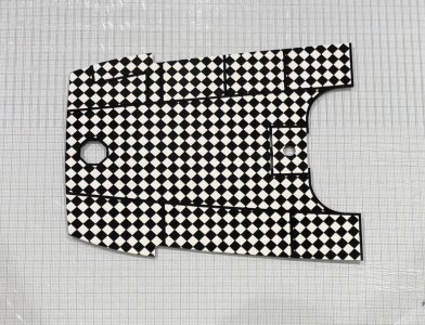

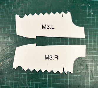

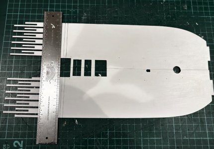

In this first part I prepare and fit the middle gun deck. This deck consists of 6 sections, 2 at the bow end, 2 mid deck and 2 at the stern. The bow and mid sections are treated as normal with stain to the upper side and white paint to the bottom surface, but the 2 stern sections present us with a new challenge. The top sides are laser scored with a chequerboard effect and we are required to make a black and white tiled effect on the upper surface.

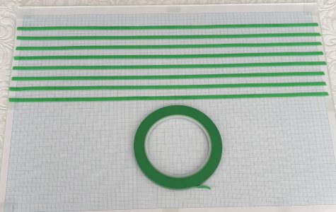

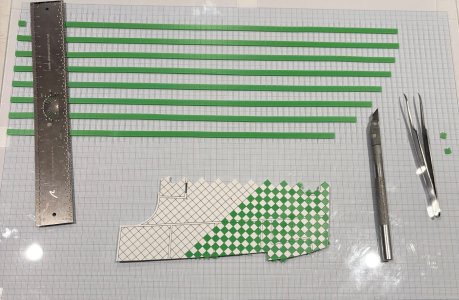

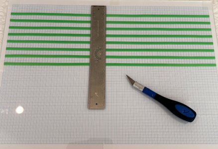

The instructions just say to cut 5mm squares of masking tape, I guess there are several ways to do this, but I’ll explain how I did it. I would think that whatever method you adopt it’s a good shout to start with a roll of 5mm wide masking tape. Believe me, I did search online to see if I could buy pre cut 5mm squares of masking tape but without success, I found plenty of 10mm squares and 5mm octagons (go figure)
I started by painting both sides of the deck sections white.
Coincidentally,I already had in my possession a book of A3 graph paper marked out in 5mm squares, which gave me an idea. I bought a A3 sheet of clear Perspex and taped the graph paper beneath it. I then laid the tape onto the Perspex following the horizontal lines of the graph paper beneath it, then a ruler and sharp blade to cut the tape down the vertical lines.

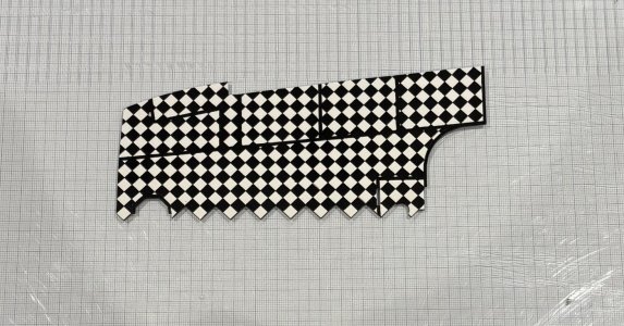

Several hour later, all the squares were in place. The instruction video only showed the builder trimming the squares along the bottom short edge of the deck pieces, but as you get further in the video it is evident that he has trimmed around all the other lines across the deck surfaces. I thought these lines were to define positions of cabin walls as on the orlop deck so it would not be necessary to do this as it would be covered by the walls, but checking forward a couple of videos revealed there are no cabins on this deck, so I did do all the trimming, it makes the chequerboard effect look off in places but I guess there’s a reason for it. My guess is that this kit is showing this deck “cleared for action“ with the cabin partitions removed. Next I dry fit the deck pieces and mark the position of beam 7 on the underside, then, using a set square on the centre line of the deck, mark and fit the beam 7 pieces. Finally I fix all the deck pieces into position.
Well, that was long and drawn out, just like fitting all those little squares in place

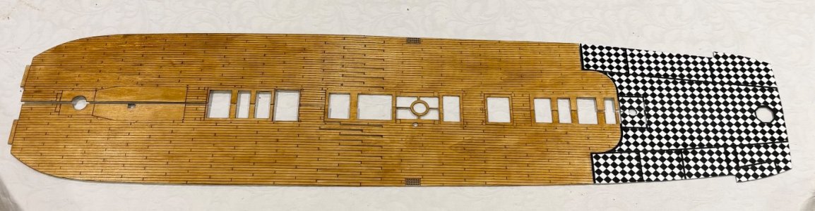

That was an incredible amount of effort. It's great that you put so much effort into it. We can only learn from that. Allow me to ask a question, though: Why didn't you use a water-soluble film, print on it, and then apply it to the surface? As far as I know, the Victory also had a kind of film applied to the floor that simulated the checkerboard pattern.
By the way: great photos!!
Hey Alan, :D
Really beautiful work and very well done. Thumbs-Up
Didn’t even think of that to be honest, just followed the instructions. Be interesting to see how that turns out if you or someone else does it Thumbsup
Hey Alan,
I used foil for the first time on my dinghy and it looks fantastic. The foil I use is only suitable for laser printers. It is burned directly onto the foil medium. This means that there will be no smudging of the ink. The disadvantage is that I can't produce white with the transparent medium. That's why, just like you, I have to paint the deck white first for the Victory. Then I can apply the foil with the black tiles to the deck. Take a look at my dinghy.
View attachment Beiboot Athena.mp4
Just a thought, not sure this has been tried before. The checker pattern was actually painted canvas rather than tiles. Has anyone drawn the pattern with CAD and printed on silk span and glued it to the deck? I tried it with bond paper years ago and it worked really well but I wonder if silkspan that is made like a silkspan sail and then "painted" with the pattern would look more realistic than paper.
That looks really good Gunther
I only have inkjet printer so that wouldn’t work for me. I have made decals in the past with decal paper that you can get in white to overcome not being able to print in white
Instructions video #27 Part 1
Lots to do in this video so again I’ll split it into 2 or 3 parts.
