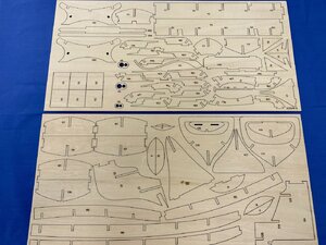

The first two sheets of basswood/poplar ply are 1/8" thick. The laser cutting is very fine with small tabs. There is zero burn on the back of the parts.

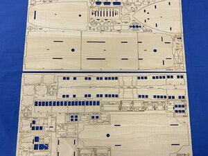

The second two sheets are the same as the first but this time about 1/16" thick.

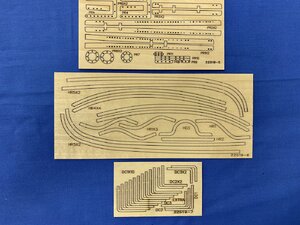

Next we have 3 small thin sheets with fine details.

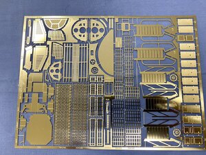

A large sheet of photo etch is included. This is a nice touch.

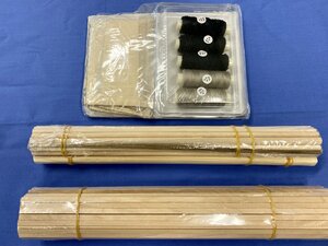

A package containing pre-sewn sails and rigging thread of average quality. Basswood/poplar stripwood, dowels and brass rod. No hardwoods are included.

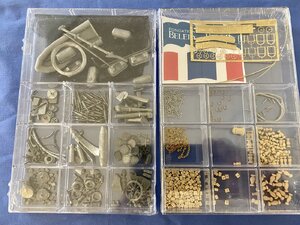

Two plastic boxes of hardware: more photo etch, silkscreen flag, a lot of metal parts, the usual substandard rigging blocks and other bits. The dinghy is in plastic.

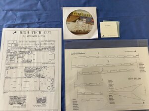

Waterslide decals, wooden parts map sheet, cutting templates, some clear acetate for windows, and a CD full of hundreds of photos and instructions. There are no printed plans or manual.
