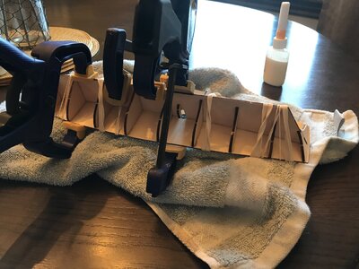

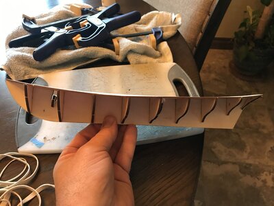

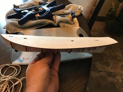

I’m building that kit now. First kit I will add. I used pva on centerline and clamped it for about 24 hours. Then applied pva to top of bulkheads, used a series of heavy duty rubber bands and also used clamps between keel and edges of deck near the middle bulkheads. No moisture or heating at all. Let dry for another 24 hrs. Worked well for me
