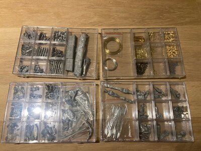

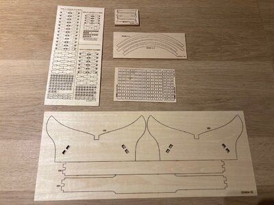

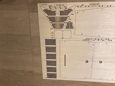

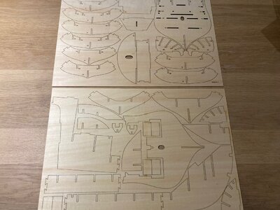

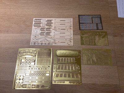

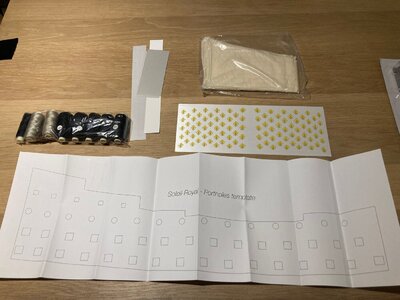

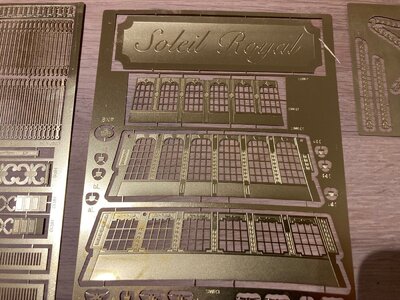

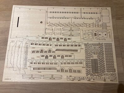

To be honest,I never thought I would be doing another kit review as I have enough projects, but this release changed all that. So here goes, I will not be going massively in-depth as to what is in the box as Artesania covers it pretty well in their YouTube video.This is more of a brief synopsis and a conclusion based on my opinion and my intention with this kit.
I will post all the pics as everything is self explanatory then add my thoughts at the end.

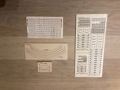

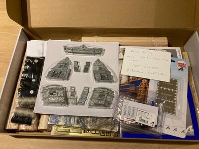

You do not get plans or conventional instructions just a CD.The instructions are downloadable via AL's website and available to anyone, you don't have to buy the kit. I have done this as it is years since I binned the DVD player. These are highly detailed full colour images with symbols used for different processes similar to a plastic kit. A key is provided as to what these symbols mean, again similar to a plastic kit.The instructions are very detailed with 390 steps, I feel anyone with some modelling experience and a basic toolkit can build this model if they take their time. I believe it was AL's intention to design a model that was buildable by a wider audience and reduce the number of failed attempts languishing in lofts, if that was their intention, they have truly succeeded IMHO.

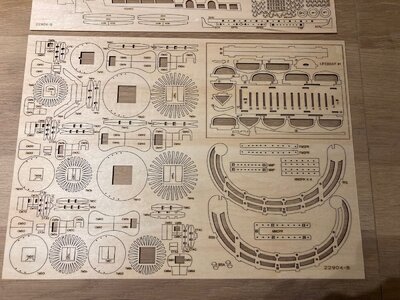

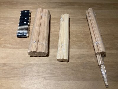

Given the price, there are one or two disappointments. The blocks and deadeyes are laser cut. The deadeyes are plywood. The blocks are boxwood but do require drilling. Given that there are 220 of these, a simple jig and a Dremel type tool will be needed to avoid monotony. The dummy cannons are only around 10mm long, the shortfall in length is made up with a small diameter length of dowel inserted into the casting to bring the ends outside the gunports. These points are clearly an attempt to reduce manufacturing costs.Also the quality of the rigging thread, especially the black is pretty dire. Just upgrading to something like that supplied by Amati would be a big improvement if you don't wish to go the whole hog with handlaid ropes.
Some of the standout plus points;

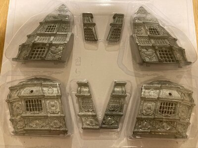

The quality of the photo etch details is great.The cast ornaments are high pressure die cast and far superior and crisper than the lost wax castings of the current Mantua model group.It is a shame the side galleries did not have photo etch windows to insert into the castings but a little careful work with a small file will improve these and remove some flash.I intend to relieve these castings on the back using the mill to give an appearance much more like that of the photo etch windows, however I appreciate many do not have a mill.
All in all this kit will build up to a nice model straight out of the box and with the addition of AL's lighting kit (which I have bought) will make a very attractive display piece.The only thing to note is that you will need the relevant Artesania scraper to produce the mouldings and this is not included in the kit. I ordered these at the same time and are visible in the picture of the box inside.

Don't want to set on the bench, but if permitted, at the area where I can see the entire build-out process. BTW, many thanks for the kit review. From the above pictures, I can see very high-quality plywood and other parts (as you already mentioned). Should be fun to build and joy to watch it is growing.

For me eye-opnening are the big number of plywood sheets, also for visible parts and not only the deadeyes
-> and I am really looking forward of how much you are using them or change them to "real" wood".
