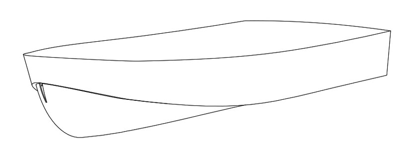

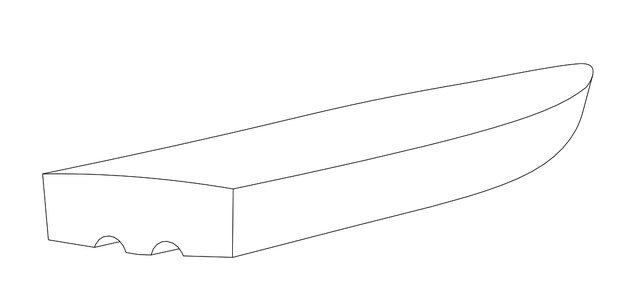

With small steps (my son recently wrote a report at school about this great man and I am still on this wave) we are moving forward. It is very unpleasant that even the drawings from the manual differ in the different projections, fortunately in the table of the same dimensions. Also yesterday I found some very good pictures of the bottom of this boat, and I will measure the distance between the screw channels from them, it also shows the shape of the screws themselves. Having the case as geometries I played around a bit with the slicer, this will be a 16+ hour print!ASPB WIP 02.jpgASPB WIP 03.jpg

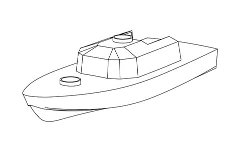

As a famous uncle with a cigar said - Never give up, never surrender:) The positive side of the story is that while I was restoring the collected photos I came across several new ones. I also read some good stuff. I couldn't find any pictures of the boats from the first series though. But given that the hull differs significantly so and so there isn't much continuity in design......in short after a lost day I'm back to where I was before the "loss". Only the nice stand I had drawn is missing.ASPB_01.jpg
