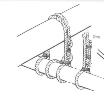

Hi, I need help attaching the yard to the bowsprit on my HMS Ontario build. There are no pictures of this in the manual that I can see and the plans don't show much either. I guess I'll have the same issue with the yards on the masts when I get there. Is there a standard way for this for British ships of that era.

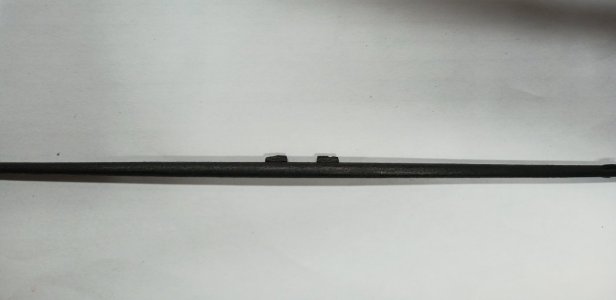

Thanks, one more question. The yard has two cleats? near the center, would the sling go on the inside or outside of them?

Also as shown on drawing right at the center of the yard there is a strap with thimble for hauling the yard up the bowsprit. Without explaining this the drawing might be confusing.
For modeling I have attached yards directly to a mast or bow sprit using a nail…drill through the yard and through the mast…then pin the yard to both with a drop of CA. I then simulate the rigging by wrapping rigging around the yard and mast. The result is a yard firmly in place but simulating the yard drawn up tight to the mast or bow sprit.
There were also yardarm cleats set up to the same proportions as the topgallant yards just as the sling cleats are of the same proportion as the topgallant yards. Hopefully they all match up.

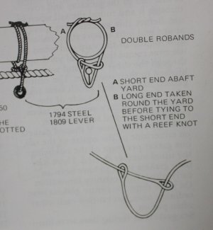

If you are going to rig the sails to the yard, assuming it was rigged similar to English ships, the following style of robands may be appropriate OR just as likely the robands might have been secured to jackstays if they were present. If there are jackstays, the jackstay bolts would be about 24 inches apart. When the saiils were being furled they were secured to the yard (or jackstays?) with the harbor gaskets. These were nailed to the yards up until about 1814. After that they were seized to the jackstays. Hopefully a member will correct or confirm this information.
