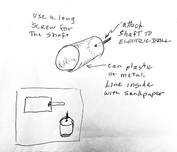

Syren Ship Models sell very realistic blocks. Another way to get realistic looking blocks is take the bad looking ones, the ones that look like miniature Lego blocks and put them a device you can easily make. Take a small can, plastic or tin, line it with sandpaper. Attach a metal shaft so that the shaft can be placed in an electric drill. Cover the open end of the can and then slowly rotate the can for about an hour or so. The wooden blocks tumble oh agains the sandpaper will round all the edges to give the appearance of realistic looking blocks.

Make sure to put a cover on the can when using it.

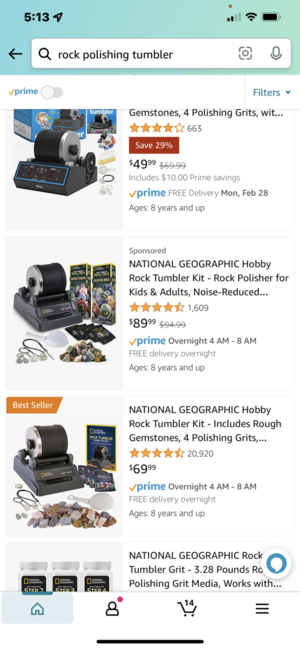

You can also use a rock tumbler if you don’t want to make this. But they are a little pricey
