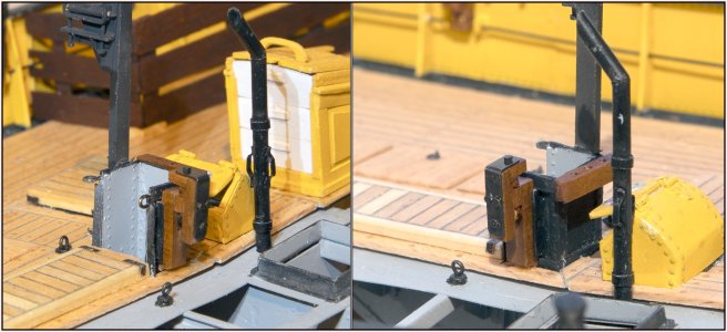

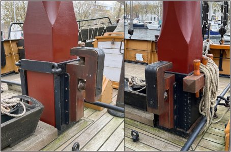

A small update on some small parts.
Two parts were added to the casing of the kosssing.
These are a nailing bench and the 'reep' guide block:

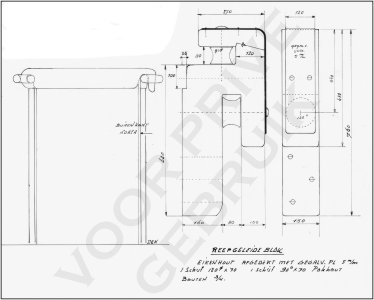

The drawings from the Amsterdam archives also included a drawing of the guide block:
After some sawing, sanding, and filing, this was the result:
Here are also some M0.6 mm bolts as axles for the two rollers and the attachment to the casing.
