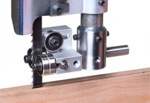

most saws take a 3/8 blade and that should work for what you plan on doing. No 10 inch saw will take a 3/4 wide blade that is in the 14 to 18 inch class of saw.
roller guides that is an extra you have to buy separate most are block guides a good set of roller guides will cost almost as much as the saw.

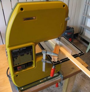

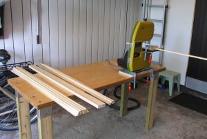

Well, I have a Proxxon bandsaw, and with a proper blade it can cut formers and FG molding plugs out of a 2x4 birch plank easily. Slowly but easily, and accurately. I have tuned that saw a bit, and the main restriction is now the power: only 80 watts. But it fits nicely to my 180 cm x 360 cm wall-to-wall workshop, and does everything I have asked for it when making r/c airplanes and other related stuff. Latest job was to resaw about 150 metres of 9 x 3,5 mm pine strips out of lumberyard boards. Broke one blade, but I have about a dozen of them, and i can always re-braze and re-set the blades until they are too dull. Any bandsaw straight out-of-the-box cuts more or less crappy until you adjust and tune it to do what's expected. Internet is full of advice how to tune a bandsaw to cut straight and clean. sahausta.JPG proxxon.JPG

Tuning your Proxxon to cut clean and straight: a few hints and pictures what I have done.

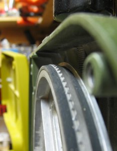

1: Crown the wheels: there is no crown originally so you have to grind that crown by yourself. Run the saw with an old toothless ground blade so that there is no danger to saw into your hand during crowning. Put a piece of coarse sandpaper on a stiff stick and use that to do the crowning while running the saw high speed, and grind exactly similar crown to both wheels. The amount of crown should be 0,5 - 1 mm, no more, perfectly spherical as in my picture.

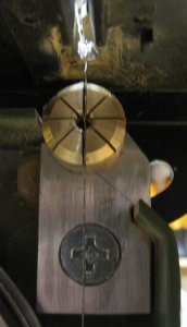

2: Make a new lower blade guide: I fixed a piece of bronze bar into a flat aluminum with a screw, tapped the hole of the original "guide" on the saw frame, and screwed my version in place with a big countersunk screw to clear the blade. Then I put on my diamond blade backwards so that the diamond edge was against the guide, took completely off the upper blade guide, applied correct tension to the blade, and run the saw with slowest speed to cut the guiding slots into the bronze bar so that the blade runs perfectly straight and true on both upper and lower blade wheels. I then reversed the bronze bar around and cut another set of slots to the reversed side of the bar. That way I can use both sides of the bar, but also made another bar as a spare.

4: Make a new, sturdy and accurate saw fence: the original is crap and tend to move around during cut. I used an aluminum angle-bar which is attached with bolts tapped into the bar, and wing nuts under the table. Adjustment is made by oblong holes where the fence bolts go thru.
