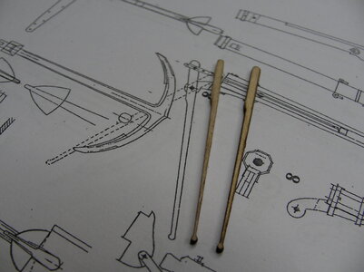

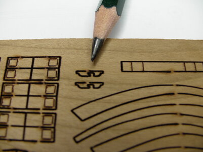

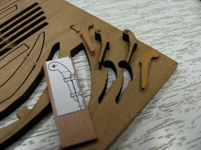

Arms for the pump levers in the laser board. And two self cut levers.
After cutting out of the board, the arms are clearly too small and the laser carbon is not yet removed.
The same is true for the levers. The left lever is cleaned, the right one still raw.
If I remove and clean these two parts, they are gone.
Granted, the components of the La Belle are very small. But they become even smaller when laser cut. Must the laser cuts be outside the lines on all lasercut kits, or am I wrong?

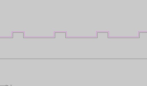

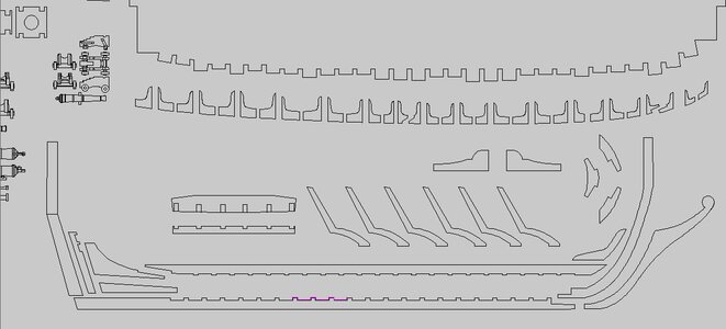

looking at this cutting file
when you zoom in close the black line is the keel part the red line is the laser path so the edge of the beam is just shy of the edge of the part
