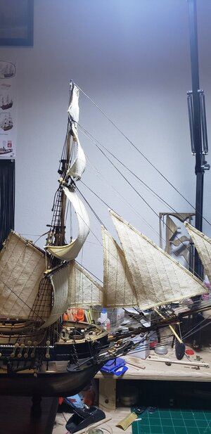

BEAGLE by occre [COMPLETED BUILD]
Nov 29, 2021
540
353
Welsh, LA

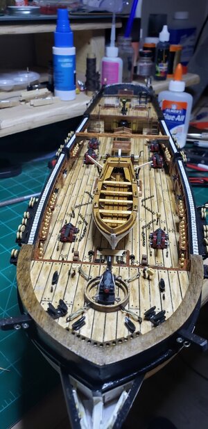

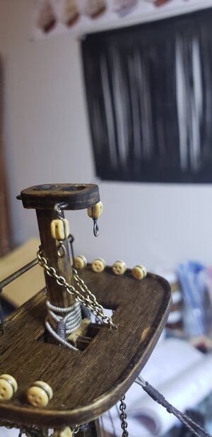

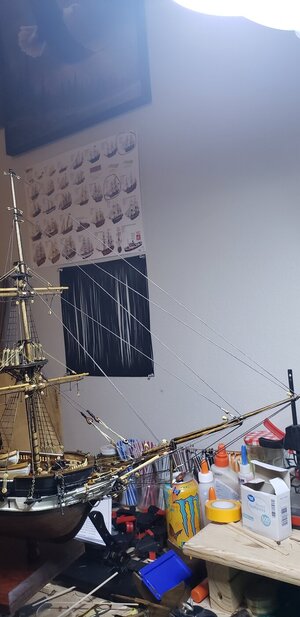

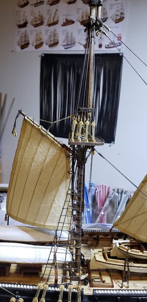

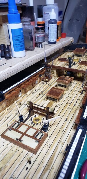

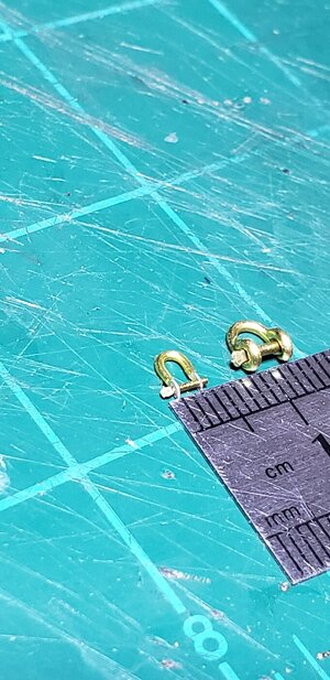

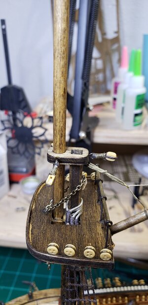

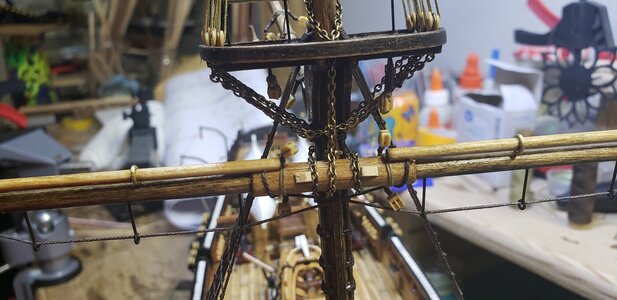

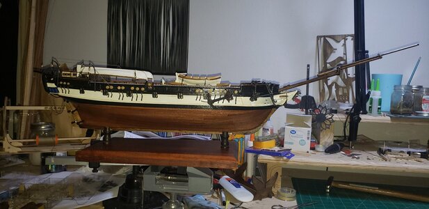

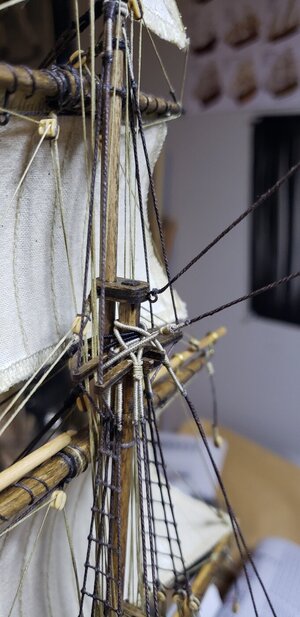

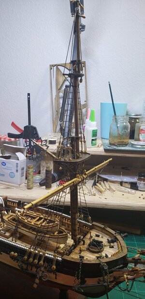

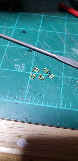

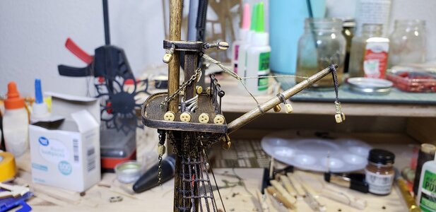

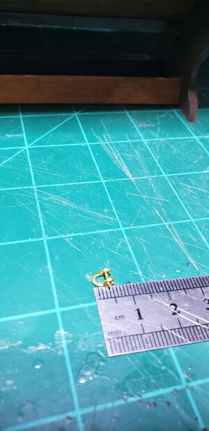

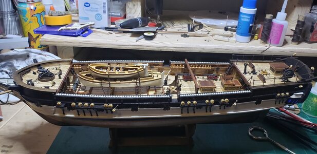

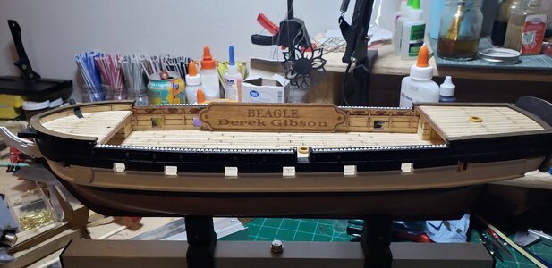

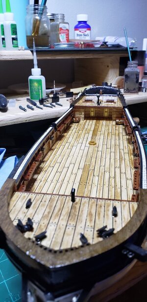

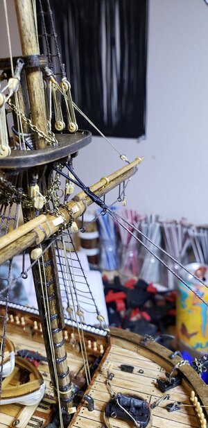

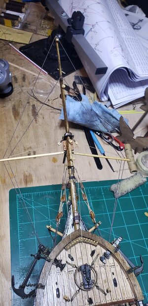

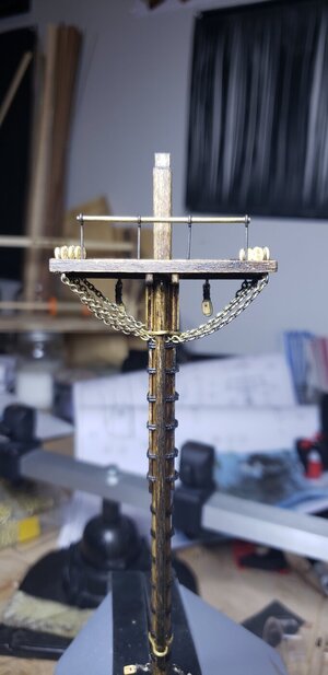

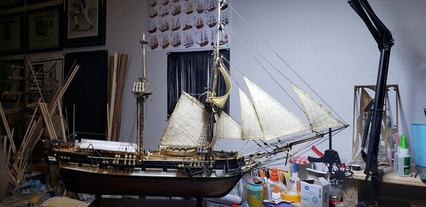

This is my 3rd ship. It is the BEAGLE by occre. I also tried to implement some things from the anatomy of the ship book. With making it with the 7 life boats. And making the futtock lines with chains. I did some experimenting with making my own shackles and even bought a serving rig. That has come in handy time and time again. Also with the decking this time instead of using charcoal sticks or pencils I used thread and I used black fishing line to simulate the nails. This by far I feel is my best ship granted learning things every step of the way from my first ship to now. And I will continue to learn as I go. 20210424_135132.jpg

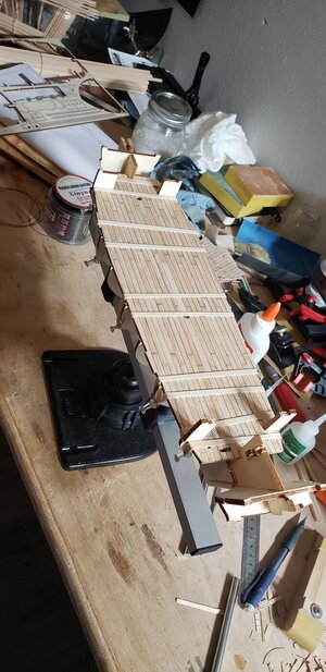

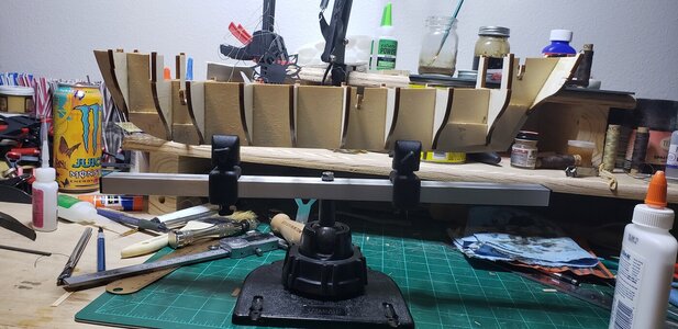

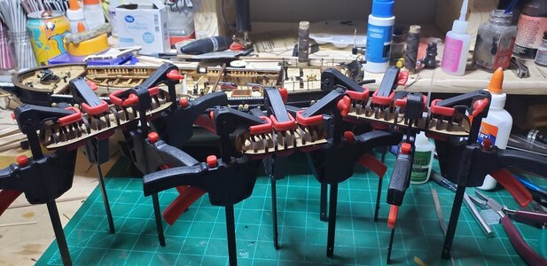

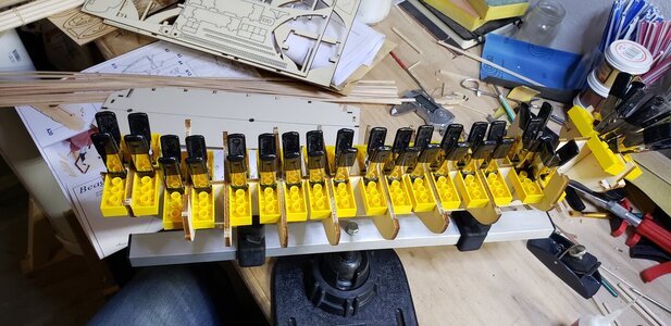

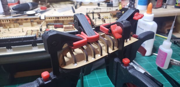

This is how I'm able to glue all my frames on the false keel at once and know that they are square

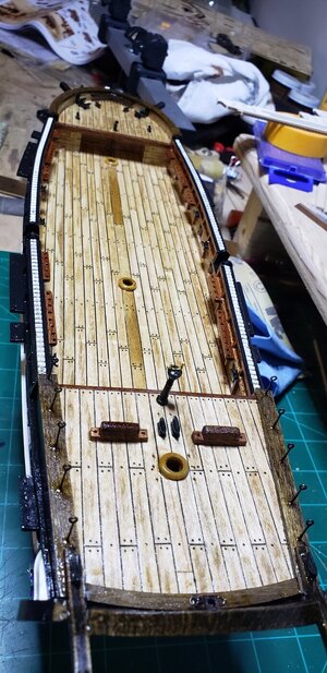

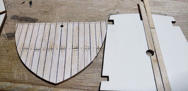

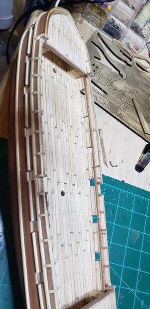

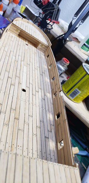

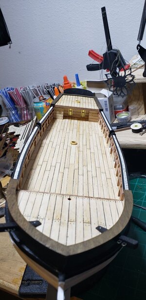

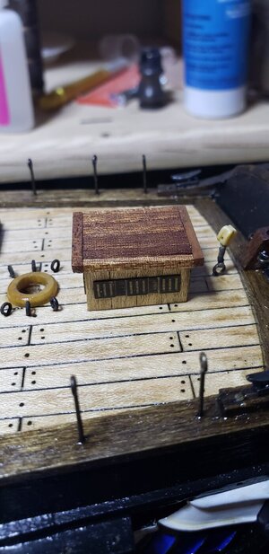

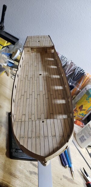

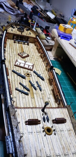

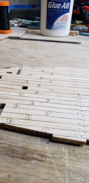

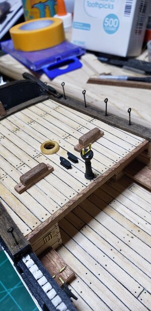

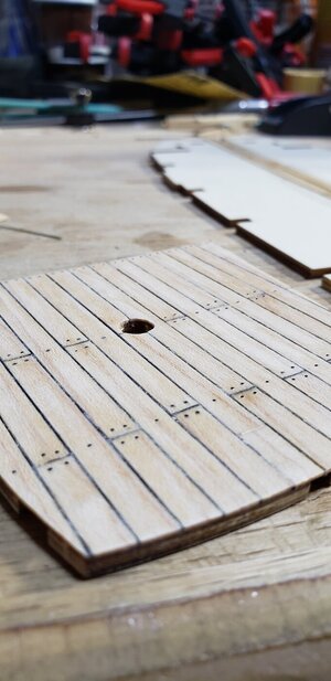

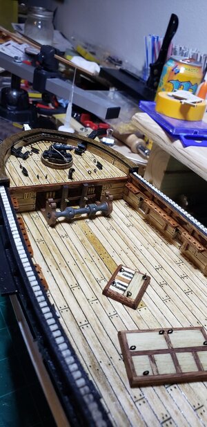

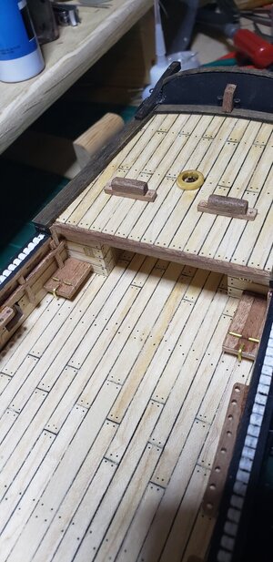

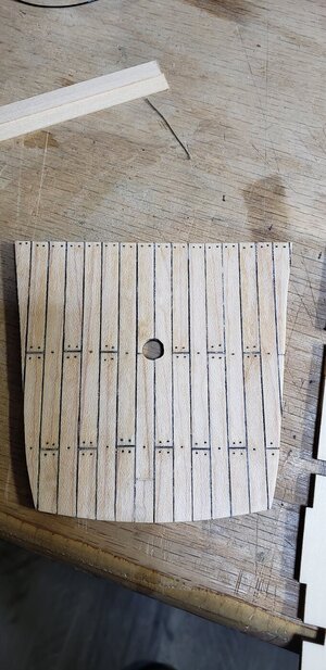

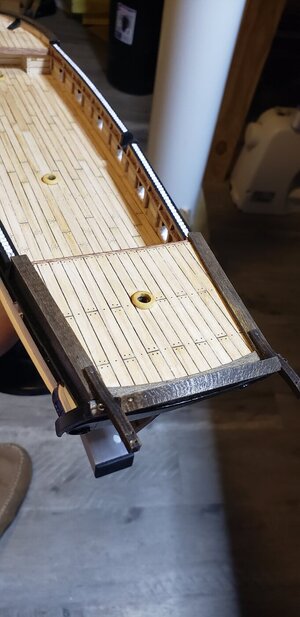

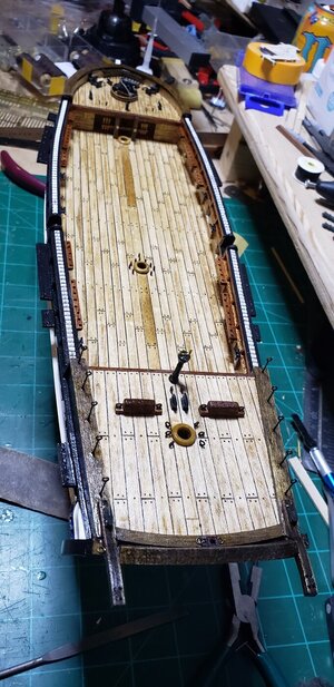

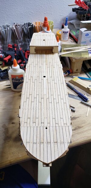

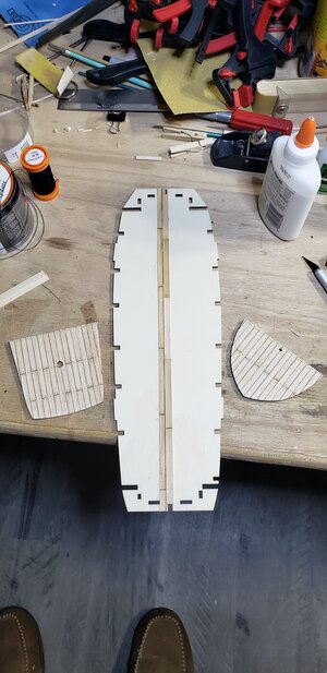

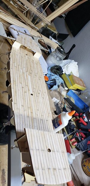

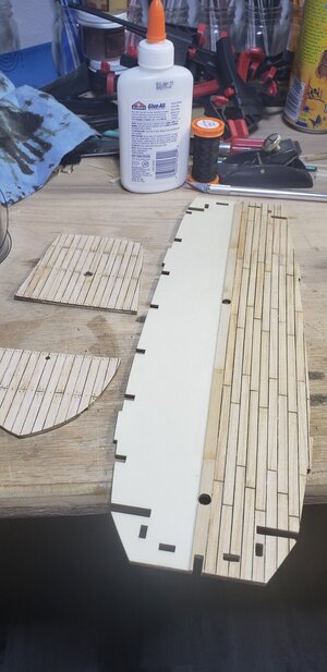

While the glue is drying over night on the false keel I decided to start doing the decking. But I want to try something different this time. I had seen someone talking about using thread. So I went and got some black nylon embroidery thread. Once I had my planks cut to size which I went with 60mm again.
Glue is dried now for the inserts at the bottom of the keel

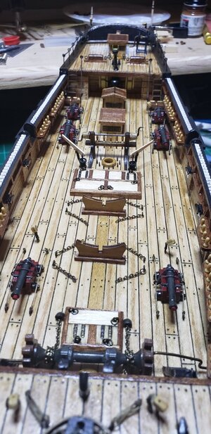

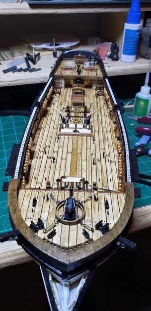

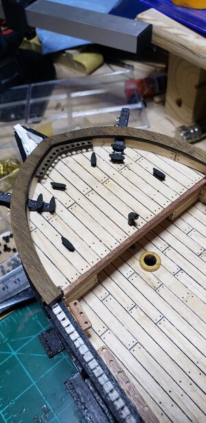

Finished the bow of the ships decking now for the main deck. For this I decided to add a king plank it is 6mm in width where as the regular planks are 5mm in width.

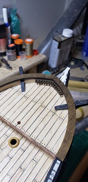

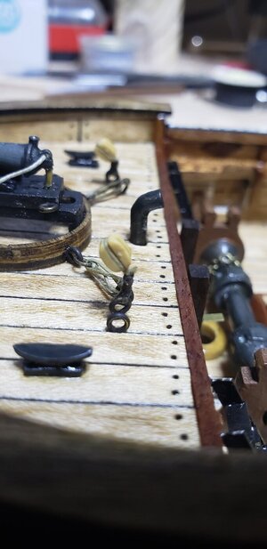

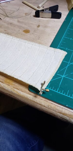

This is what I used for my nails on the decking and walls and bulwarks on the inside as you'll see.

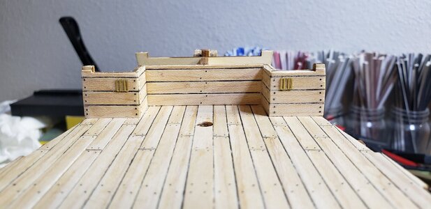

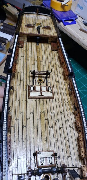

20210721_202903.jpgbow and poop decks are done. 20210723_210708.jpg20210723_210714.jpg20210723_210719.jpg

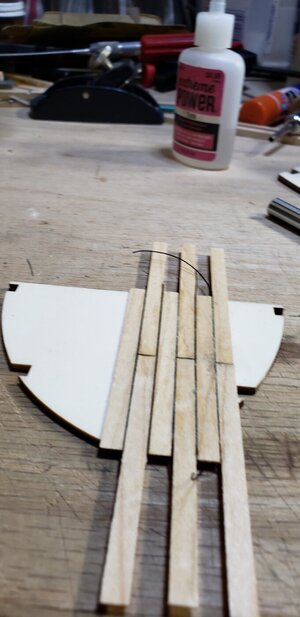

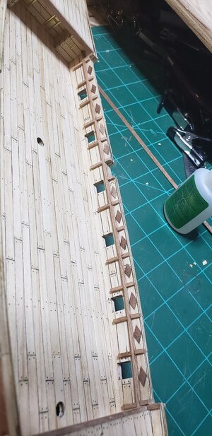

Working on the main deck and also putting a staggering layout for the planks.

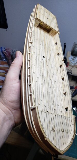

Test fitting the decks on the frame making small adjustments as needed.
As you can see I'm also lining the walls with the tread for the caulking and using the nails aswell.
Securing the main deck to the frame.

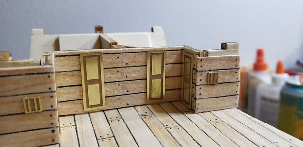

20210727_010217.jpgback what towards the stern of the ship. 20210728_170059.jpg20210728_170103.jpg20210728_170123.jpggetting the bulwarks in place and secured. 20210728_201531.jpg
The inside of the bulwarks are planked and caulked and nailed.

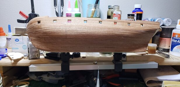

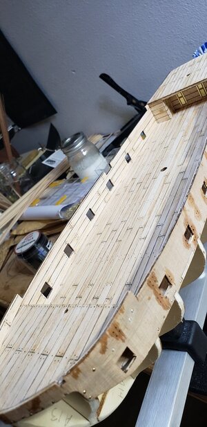

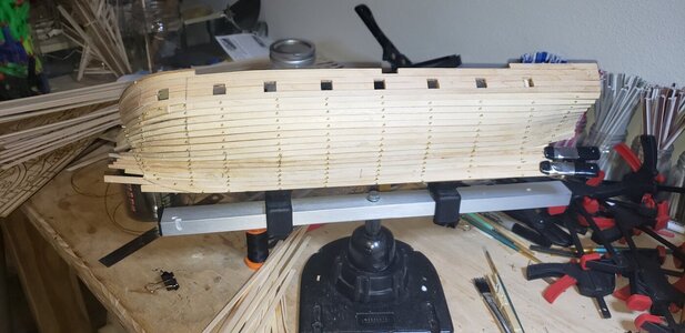

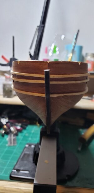

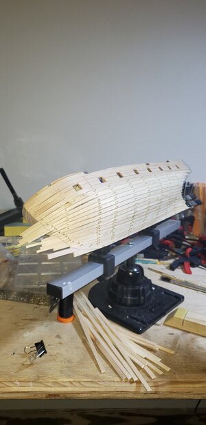

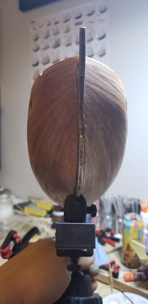

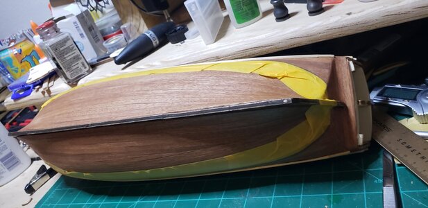

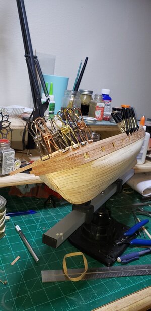

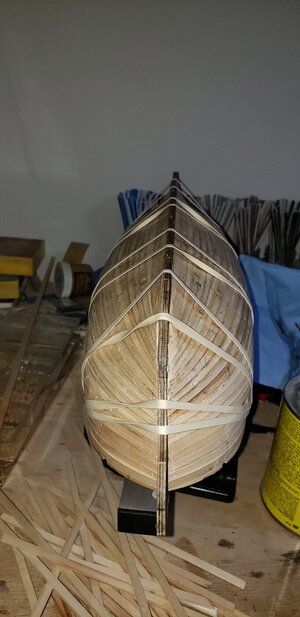

Getting the first layer of planking underway.

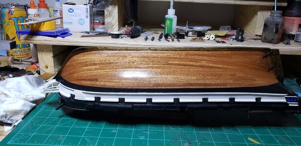

Once all the planks are on and dried I pulled all the nails out and glued the keel together and put of the ship to keep its shape. Once dried I took it off so I could finish the rest of the planking.

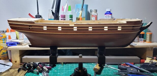

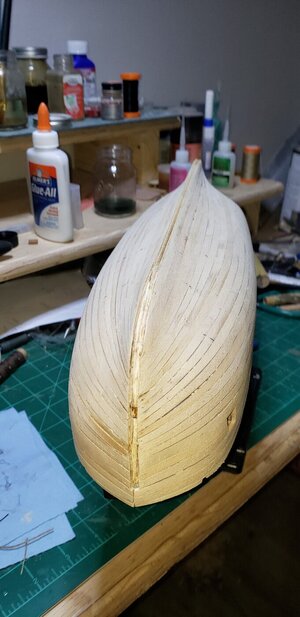

Hull is sanded smooth ready for second layer of planking

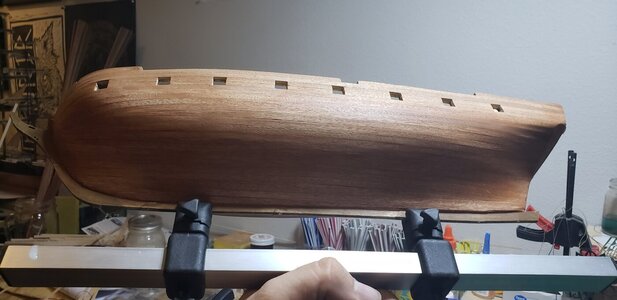

Second layer of planking going down
Got the keel attached now

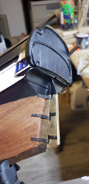

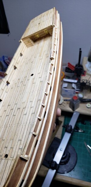

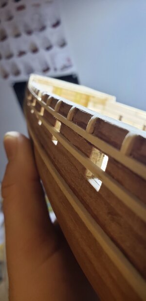

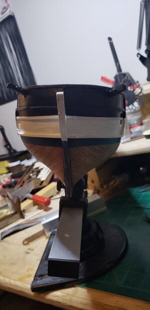

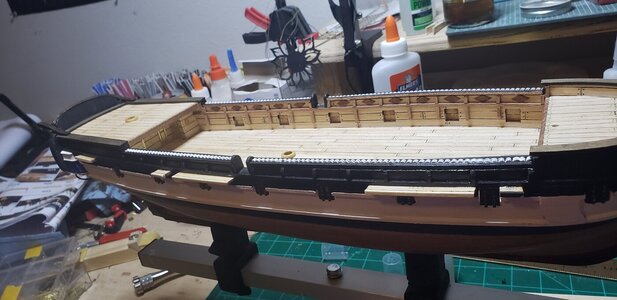

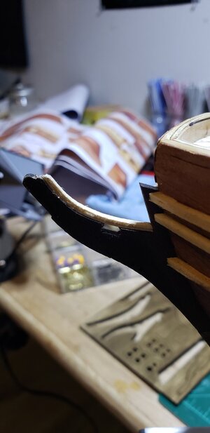

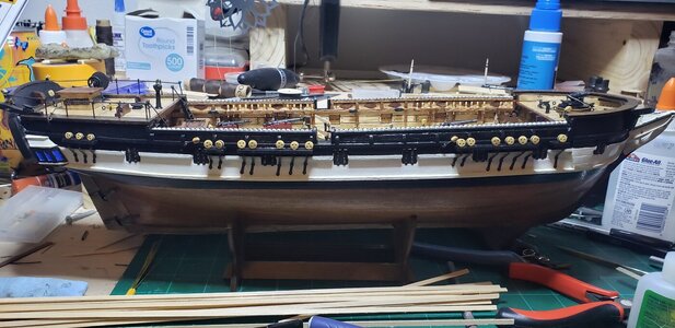

Got the rubbing strakes put on

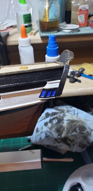

Had a little booboo found out cant put too much pressure on that spot. Fixed it and once paint never know it wasnt like that.
Rubbing strakes and vertical nibs on and rounded off
Now getting the inside of the bulwarks ribbing done.

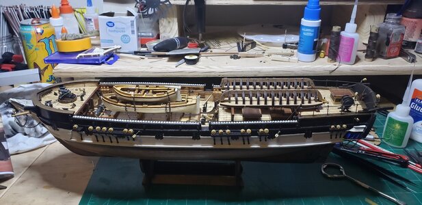

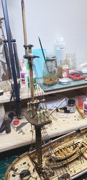

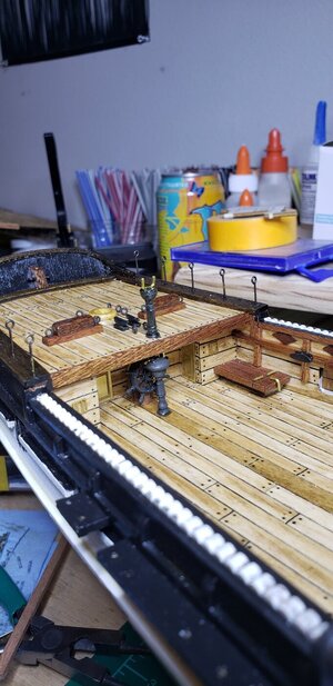

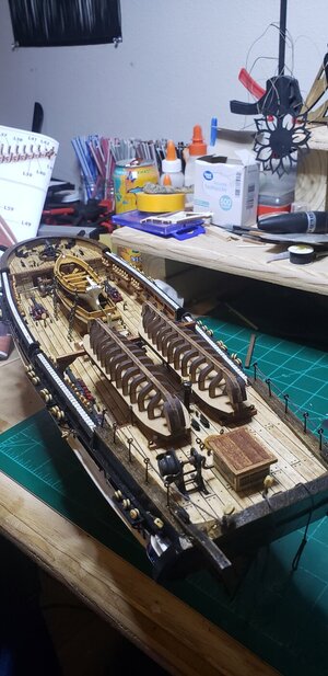

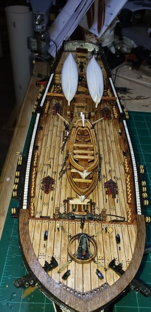

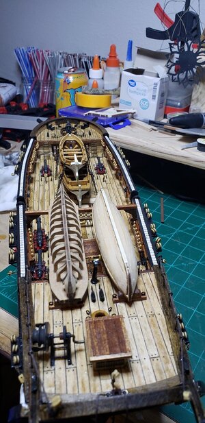

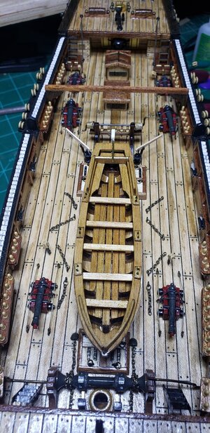

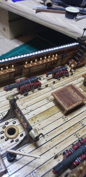

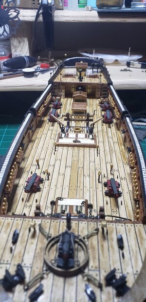

Just about everything is on the deck

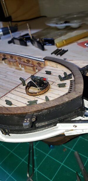

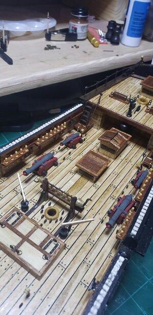

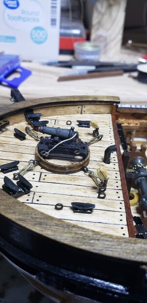

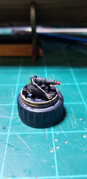

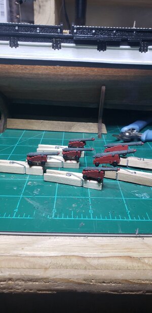

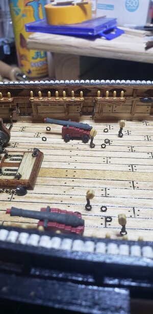

Mocking up the carriages for the cannons
Painted the carriages

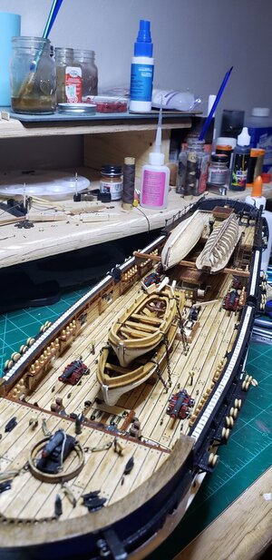

Dry fitting cannons on deck

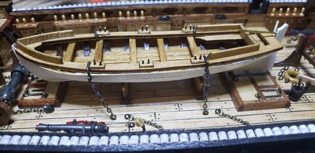

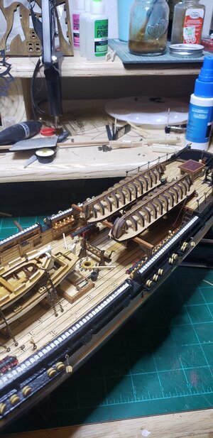

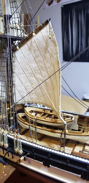

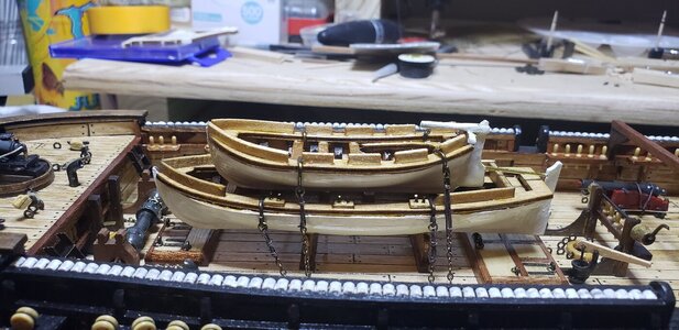

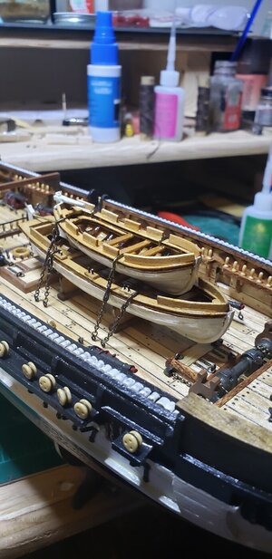

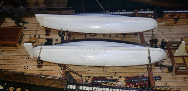

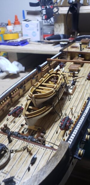

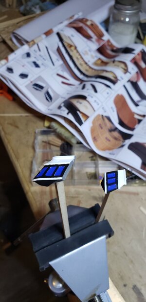

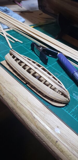

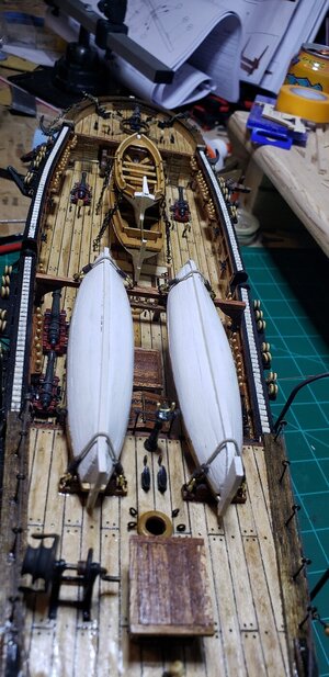

First of 7 lifeboats

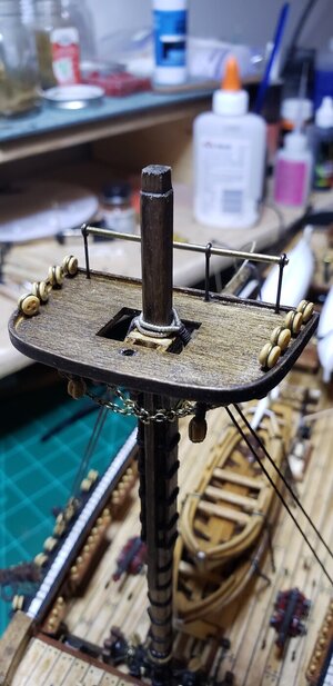

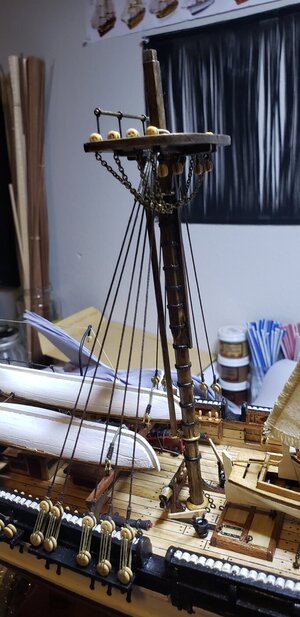

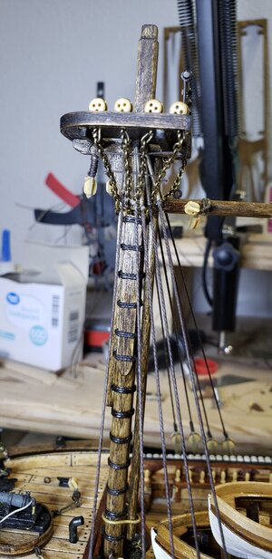

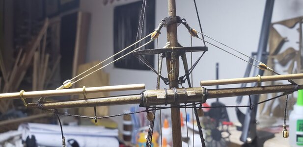

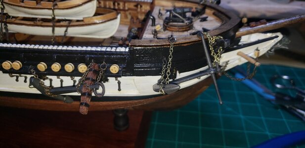

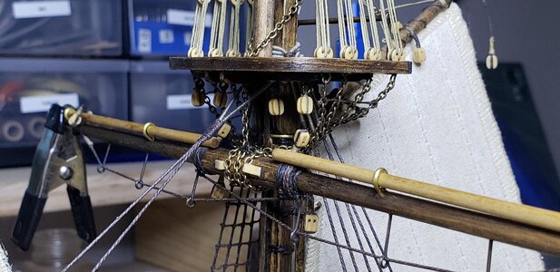

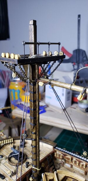

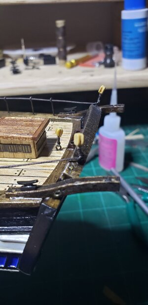

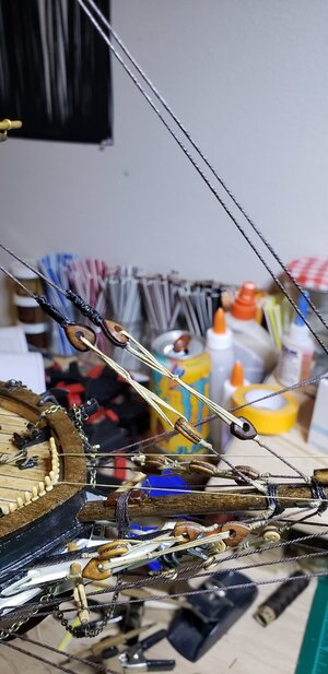

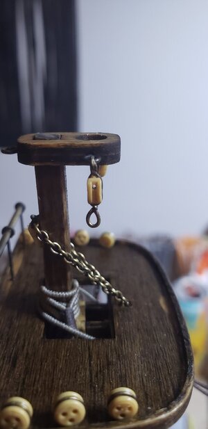

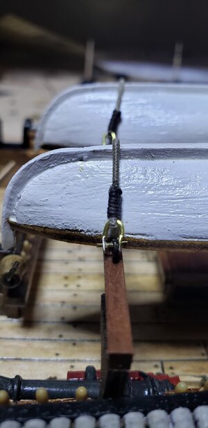

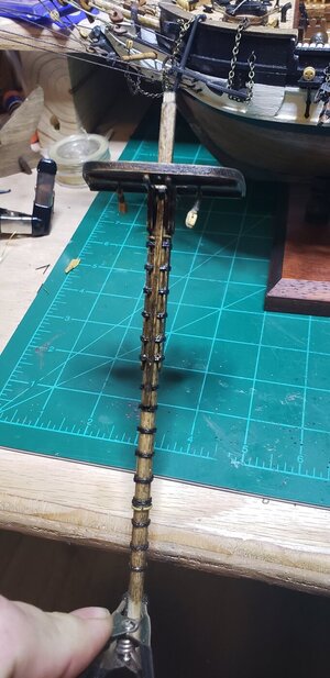

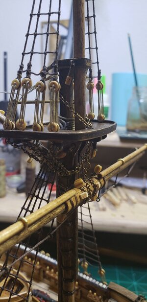

20210830_074455.jpgcannons and carriages are now in place and rigged down20210831_083010.jpg20210831_083015.jpgfrom anatomy of the ship 20210831_083030.jpghanging dedeadeyes 20210831_083044.jpg

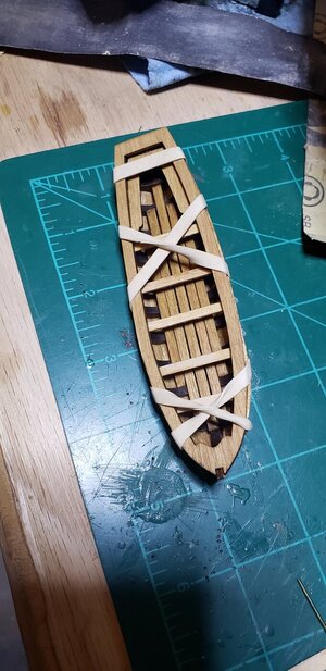

First of 7 life boats

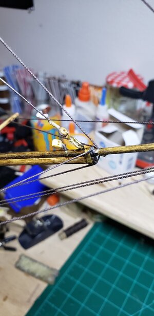

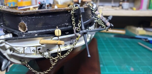

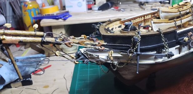

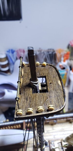

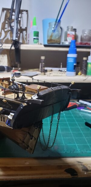

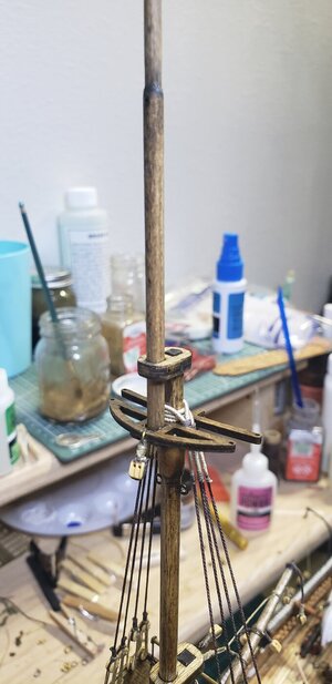

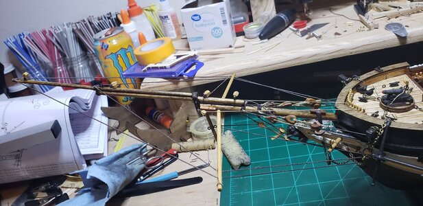

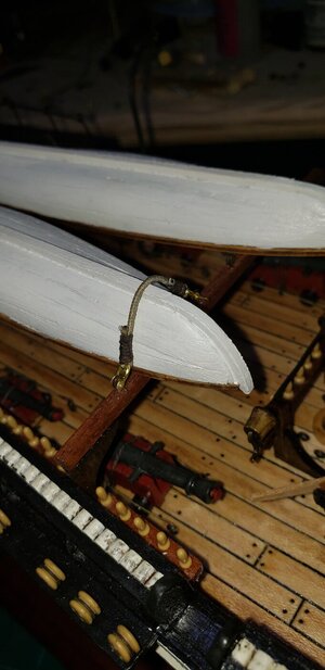

20210902_101311.jpg20210902_160743.jpg20210902_160748.jpg20210902_191228.jpg20210902_191241.jpg20210902_191252.jpg20210904_200537.jpgrudder chains hung 20210904_200800.jpg3 more life boats waiting on the other 3 to come from occre. 20210905_220134.jpgfirst 2 lifeboats fitted20210906_022743.jpg20210906_022746.jpg

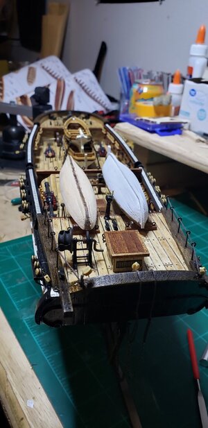

Checking to see how the other 2 will go.

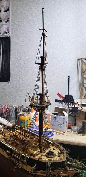

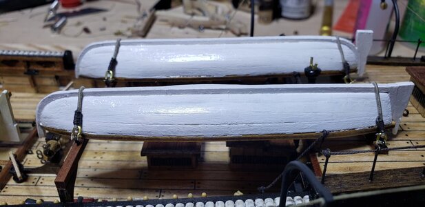

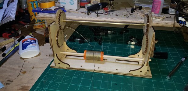

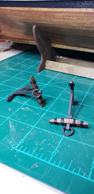

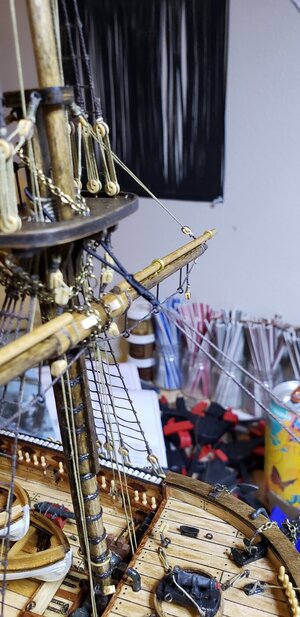

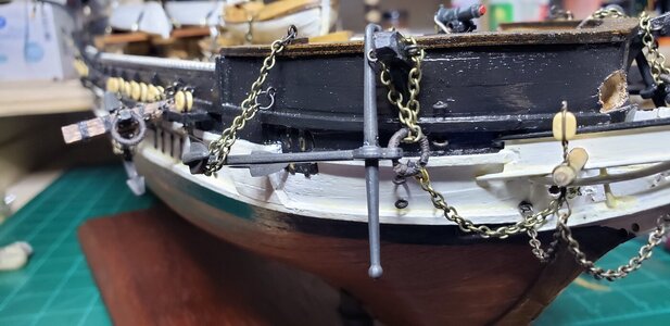

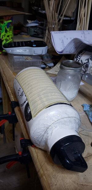

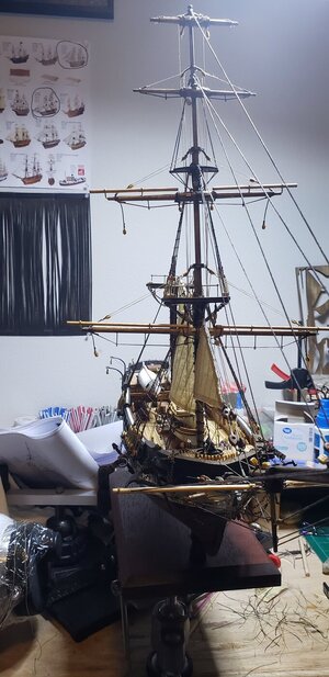

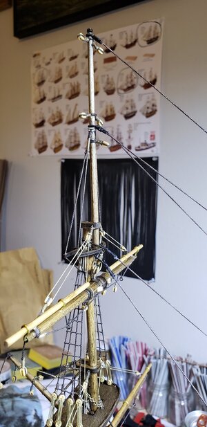

20210906_022934.jpg20210906_022942.jpg20210906_022952.jpg20210908_143453.jpg20210908_143502.jpg20210910_081037.jpg20210910_081026.jpg4 of the 7 done and in place now to strap them down 20210911_083138.jpg20210911_083145.jpg20210914_201606.jpgtrying to decide which one I liked best but I'm leaning more towards the left20210909_060839.jpg20210909_060845.jpgdid away the metal cross members on the anchors and made wooden ones 20210909_081936.jpg20210909_081952.jpg20210910_081559.jpgrope serving machine came in. It's worth its weight in gold20210915_204600.jpg20210915_204606.jpgusing the served rope I made and the shackles to hold down the lifeboats 20210915_210422.jpg20210917_205439.jpg20210917_205446.jpg20210917_205514.jpg20210919_200103.jpg20210919_200350.jpg
