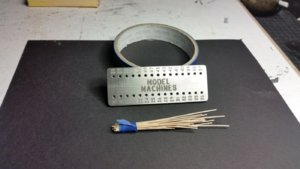

Good day all,
I am testing bolts size. How do you think witch one is more like it was in reality? They will be for futtocks parts joints scale 1:32. What size of bolts(nails) heads was in real size? For treenails on the deck I found that it was 3-5 cm head, but I think in futtocks joints it mus be bigger. 15738407930682013448221840445774.jpg

Personally I would not go much more than 1mm diameter head even at this scale,especially if you blacken them.1mm is around the correct size,possibly slightly small.However if blackened,visually they will appear bigger than reality and they don't want to draw the eye away too much from the rest of the model.

thanks Nigel, for my eyes 1mm brass wire looks somehow nice and proporcional, thats why I decide to test several sizes just for "how do they looks" and to check historicaly. Yes I am going to blacken them later, now just preparing. Thanks again.

I have found the railroad spikes to be very effective for period models due to their strength and colour. If the head size is a little out of scale give them a couple of strokes with your needle file before driving them home.
