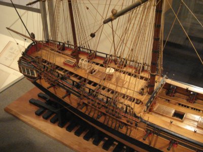

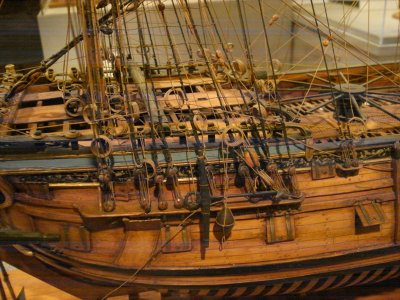

Won't be near my books for another day or so but many/most lines were tied to the rails and timberheads. This can be clearly seen on many contemporary models. The below are models at Preble Hall. I realize most of these models have been re-rigged in the past two or three hundred years but hope they were faithfully replicated.
