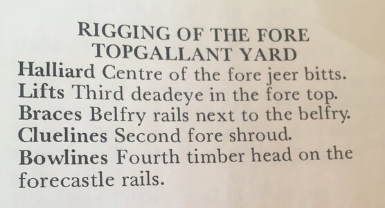

In Lees pg 177 belaying on the Medway I took this picture
The cluelines say "second fore shroud". Elsewhere he says it's belayed on the fore top. I'm confused as to where and how it's belayed. I'm assuming that "second fore shroud" would be the lower shroud. Petersson has it belayed on the pinrail on the fore deck so that doesn't help. But Steel agrees with Petersson. So what and where is the "second fore shroud" in this case??
I decided to use my new rule, " If in doubt belay it at the furthest away point as you can". Then if you find out later where it really should go you have enough slack to move it there.
A conundrum to be sure Don. Regardless of how you proceed there are options and as you know, there were variations from ship to ship even within the same era. Strictly a guess but would the second fore shroud be the second lower shroud where a cleat would have been used for belaying the clue? Same goes for the main topgallant clue as Lees writes that it belays to the second main shroud. Whichever way you go, you have backup evidence should anyone question how you
do it.:)
do it.:)
Thanks for the post Alan. That was as far as I could guess too. I don't like making/attaching/belaying to shroud cleats so I'll think about it for a while. When you start seeing the end of this rigging you start to realize that for the most part 'you can't see the rigging for the ropes' ;) so I guess one:D :D:Dmistake will get by.
