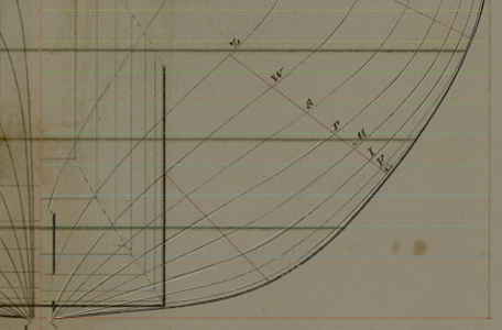

I have been reading and re-reading David White's "Understanding Ship's draughts." Trying to fill in blanks I have also been looking to Sutherland and Steel. As a lab exercise (didn't I tell you I went to a technical college?) I copied the Bellona body drawing into a new work space and tried generating circles using the available centers and radii of curves found on the drawing. I then used a 3 point circle tool and attempted to re-generate the curves that had no supporting data. Lastly, I used straight lines to fill gaps between the circles. I have left the circles intact just for this exercise. I also have the body drawing in the background.
For the attached drawing I located the largest error between the new curves and the body drawing. If my arithmetic is correct, the error is 1 inch at full scale.
Christian has been providing some insight. I am hoping I am going down the path he suggests.
Anyway, enough stalling. I have archived all of my CAD work to date. Of course I borrowed the basic material I will need to go forward. I am going to start over on my drawings. First I will clean up the body dwg (see attachment) and generate all of the curves in the body drawing using arcs. I will only use straight lines when absolutely needed. From there the plan is to go back to Kempson's CAD guidelines and generate the half breadth and sheer plans.

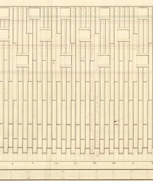

Yet another question. The attachment is a close up of a Bellona Sheer plan in the mid ship area. I was under the belief that the center mark would lie on a bend's joint. The mark appears to me mid "frame". It also appears that the same size frames are not centered on the mark. Can someone explain what I am looking at?
warren

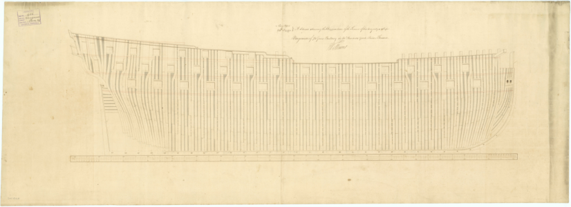

Do you mean where two frames are next to each other? If that is correct I think you are right. Looking at several framing dispositions for 74s at the time of Bellona, all frames are on each side of the station lines and the midships station is indeed the join of two frames. One example is below
I cannot tell from your image. Looking at my attachment, I see the station marks at 2, (3), (2), (1), X, (B), A. 2 and A are normal station lines. As I understand it, the other 5 are similar frames. The X should mark the dead flat but I thought it would be at a join line, not the middle of a frame and not off to one side in a group of similar frames. I still think I am missing something.
warren

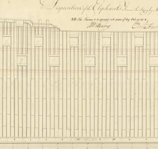

The below may be more clear. The first is a portion of a high res drawng of Elephant (74) 1781. In this case there are three frames at midships with the forward most sitting on the midships station Ø and what Steel calls the Dead-Flat nearly area from frame (2) aft to frame (C) forward. The second drawing of Rodney has only two frames at midships plus several more in the Dead-Flat nearly area.
Christian, Allan
Thank you. I can see my error. I have been under the impression that the midship station had to be in the join of a bend. I can see from Allan's images that it can be in the center of a frame OR in the join.
Thank you again for your patience with this old man.
warren

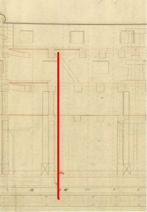

It definitely varied. Unless you can find a framing disposition of Bellona I would go with her inboard profile plan (below). You can see that the midships mark was changed and moved slightly aft. Taking into account the aft edge of the frame that would form the forward edge of the gun port (red line below), it seems that for Bellona midships was in between frames.
