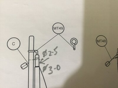

Hi, I’m trying to make the loops from 1mm brass wire that hold the stun sail booms. On my Occre Beagle it shows a loop with right angle bend that is inserted into end of yard. Stunsail booms are 3mm so loop would need to be 3.5mm. I have tapered point pliers buts hard to get loop 360 degrees. Right angle bends are fine with pliers. Forming loop around lime wood doesn’t work because wood is too soft. Part is MT49 on picture
Is there a tool to form nice loops in the wire? Or is there a nifty technique you have?
ThanksView attachment 457519
