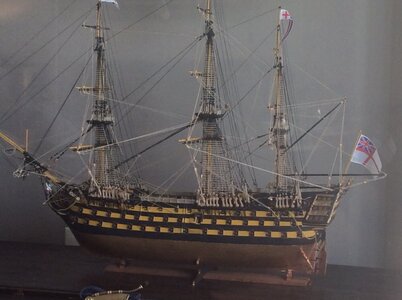

Hi,
I built the Corel HMS VICTORY. I found that the instructions appear terrible until you really read them several times with the plans, then they are sort of ok. The rigging instructions and plans were good.
Also Corel takes a lot of licence with the accuracy of the plans: ie. they place the helm and binnacle out on the deck away from being under the poop deck. Also no office fittings(doors etc., though no one would see them. I did put them in my model.
I would suggest you try to get a copy of the real deck plans.
It was a good model. I made it for my Grandson for his office to remember me later on.

What a great build...and a beautiful rememberance your Grandson will have!
