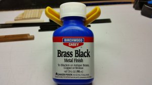

I've bought this type.
Want information on how?
How should it be mixed, 1-10 water?
Do you wash the brass in alcohol, acetone or anything else before brass black ?
After brass black, is the brass washed in water or something else?
