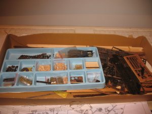

I'll post some pictures of the box and supplies. I does provide rigging, sails, deadeyes, blocks, all the wood needed. Included 6 sheets of plans with numbers only as reference.

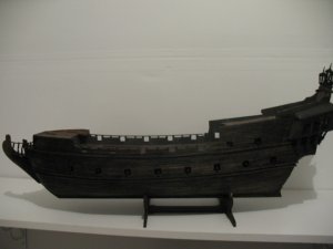

Thanx for the complement on my Build I am waiting on some new planking and I can get back to it. Ill be giving this Build to my Grandson as he's a big fan of the movie and loves pirate ships. The ebay kit I got was just so bad it would have been impossible to build that ship without having to spend at least $200 more and I would have had to fabricate quite a few parts that were missing. it came in a plain brown box that looked like someone just threw everything in the box and shook it up a few dozen times lol
The parts were just fine, the figurehead and stern figures are of a cast metal and are of good quality. Later today I will try and send some picture of the box and materials. I will be closely watching you build as good reference for mine. Thanks

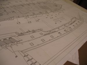

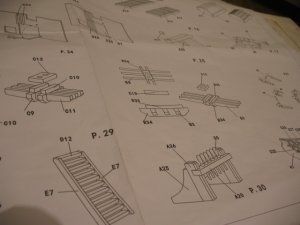

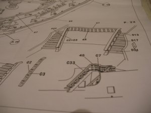

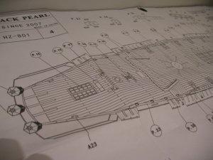

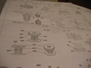

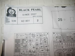

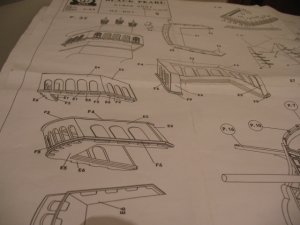

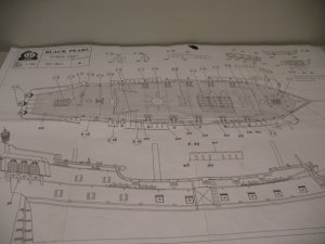

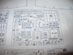

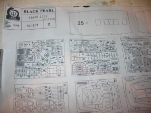

These are pictures of the only plans with the kit. There are on written instruction of any kind, you need to try and match the numbers shown with the corresponding part on the "A" "B" "C" "D" or "E" wood laser cut sheet. Trying to figure out what number goes with which part has been a challenge.
mine is listed as ZHL- 506 so definitely a different version the Box looks similar though in that they use a decal on the box as apposed to printing directly to the box. This has to be the one folks were talking about being difficult to build due to no clear build instructions. I honestly thought that's what I was gonna get when I bought mine from Max. I thought I'd be able to figure it out. Turned out it came with instructions so I was happy to see those. That got me thinking Maybe the ones folks were talking about were the first Mess I ordered from ebay. I know what you mean about the A,B,C,D thing, The instructions don't tell you those letters correspond to the laser sheets I was like WTH I Guess I just have to look through every single sheet to find a part that looks like the part in the instructions while I was doing that I found the letter on the sheets and a porch light came on AAH-HAA I started the Log for that ship just incase someone had one without instructions but it appears the kits aren't exactly alike anyhow. So I hope my log is atleast good reference for folks to follow and get the ship built. I hope to have the planking in a couple weeks at most and I can get back to that build. I tend to build things fairly quick because I have a good amount of time to work on my models so I should catch up to where your at in a day or two. Ill keep posting a detailed build so hopefully you see something that will be useful to your Build and help you complete that one.

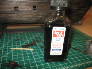

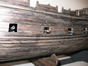

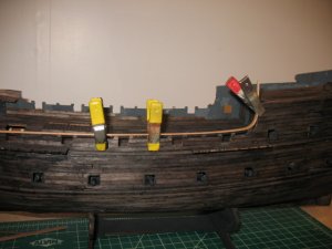

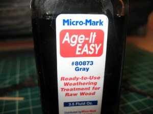

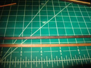

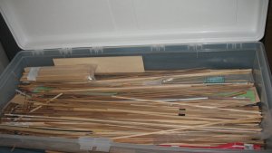

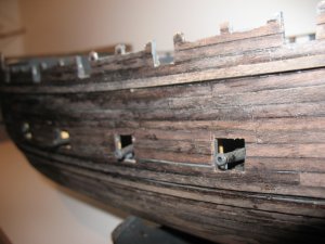

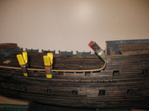

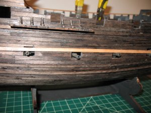

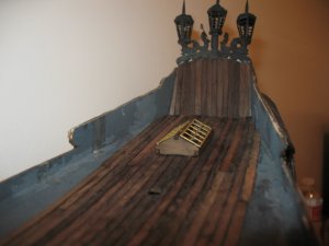

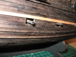

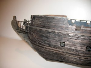

It will be very helpful to follow along with your build as you go. I'm retired now so time I have. I am posting some pictures of the second planking I received. It was so light that if I wanted a "Black pearl" I would need to darken the wood. I decided I didn't want to paint so I used some wood stain from Micro-Mark.
I wanted to wood dye mine as well as I use that stuff on Guitars and they come out Beautiful once the clear coat is applied. I use the Trans-Tint Brand its expensive, but I have always gotten consistent results from it. The Problem I had was the planks are of a different wood then what is used to make the Plywood laser cut parts from so they wouldn't take the dye the same I didn't want to go through the process of trying to blend every single part to match so I chose to use Tamiya XF-1 paint for all the Black parts. That paint is water thin with an alcohol base so it dries fast and sinks deep into the wood leaving the grain raised so it looks like Black wood in the end and Not a gaudy thick painted surface. The coverage is fantastic as well and so far is covering in a single application. I have used that Brand of Paint for everything and I like it a lot. Unfortunately I'm still 10 years or so from retirement, But I no longer put in 60+ hours a week at work. All work and no Play was making me a very dull boy so I now limit my work hours from 40 -45 hours a week max. I go in early at 4AM so I'm off before the rest of the guys this is great in the summer as I avoid the hottest part of the day. since I'm off early I have more daylight hours to do things I like to do. I spend a good amount of time with my Grandson when he's here he likes fishing so we go often, a few more years I'll have him Hunting with me.
