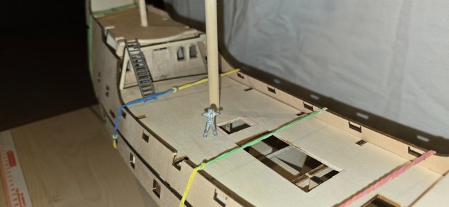

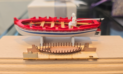

Great that you're asking a question. Feel free to ask anything here in my construction report. As you've seen, I'm converting the Black Swan into the Athena. So, feel free to take a look around here.
Regarding your question: you mean the deck planking and planks B2, right? Take a look at your legend. It says "sycamore wood" for B2 and the dimensions 0.6 × 5 × 50. These are the deck planks amidships.
Wood types (lime, sycamore) are also used for C1–C10, with different dimensions. So be careful! You will need to use these when planking the stern, bow or bowsprit.
Please refer to the construction manual provided. Thumbsup

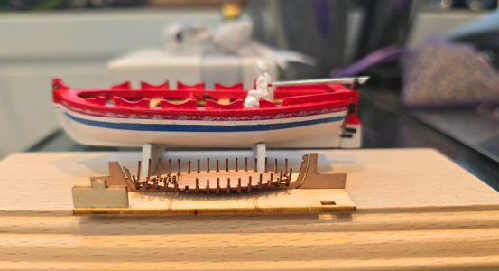

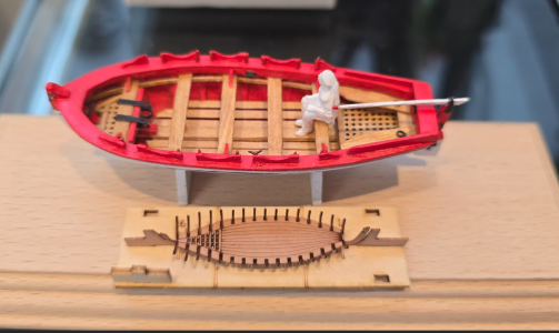

Thank you very much for replying to my comment. I have been slowly going through the comments in this thread and I am a great fan of the custom dinghy for your build.
I am just really worried about messing up. I did measure the ones that they provide and the lengths for the sycamore are either 40cm or 60cm. I did notice that some of them are much thinner which makes me think that those are the ones for the hull. I don't want to delay my work any longer on this so I think I will make the most educated decision I can make and live with the results.

When you say thinner are you speaking of the breadth or the thickness? I realize this is a 17th century fictional ship but I am guessing, based on actual ships. if this is for the ship's boats, the planking would likely be less than an inch thick. (0.33mm at 1:75) and about 6" to 8" broad (2mm to 2.7mm) Not easy to work with. Planking that is a little thicker can work as it can be sanded down.
