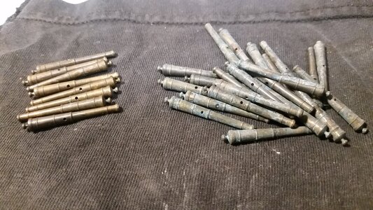

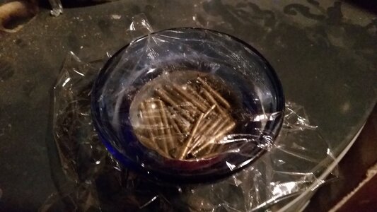

If you don't have any brass browning solution, here is a method that works. If you want to brown the brass, not blacken it, take a sealable container from the kitchen, pour some household ammonia in the bottom, float a smaller container holding the brass parts on the ammonia, seal the container, then place it in a warm place, like in your car out in the sun, or on top of your house water heater. Wait 18 hours.
Small glass bowl with the cutoff bottom of a soda can holding cleaned, brass cannon barrels. Plastic wrap and a rubber band seal the bowl.

Fully ammonia fumed barrels on the right (exposed 18 hours), partially fumed barrels (exposed for 3 hours) on the left.

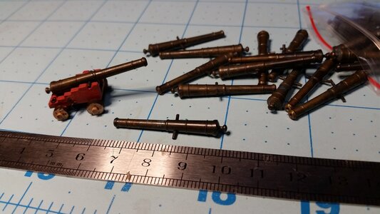

Lightly burnish the barrels with a Scotchbrite pad to polish off the white oxide, and you get a nice, browned finish which has a bit of texture so it looks to scale.

Thank you the browning technique idea Rob444! Being ammonia, does it not create the lovely smell?
Great result!!! Thank you for the advice
