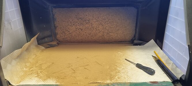

If you plan to build something like this a Dremmel is really essential along with some form of dust extraction be prepared for LOTS of dust

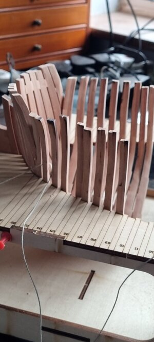

She has now gone home so I have had a full day and managed to get all the frames fixed to the keel only managed to break two lol
They are not very straight so I am hoping that once the spacers are fitted they will help to make it more shipshape and not likes the dogs hind leg
As usual suggestions and comments are all welcome

Hi, If you look at page 9 of my Blandford log you’ll see a simple and very effective way of getting the ribs straight. Ken
you ment the rubber bands, or?
Here is the link (I choose page 8 where you can see it better)
BTW: Ken ´s method is working only with such colourful rubber bands - never use bands with a unique colour !!!! ;)
