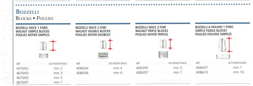

So when we say a block is single, double or triple, that is not hard to understand, but when they say a 2mm block, is that height, or width, and if so, how is it measured, from top to bottom of block body or from size of the wheel inside the block?

So then a 2mm block is measured by the external height of the block.
That is what I thought, and hopefully this will help others who have the same questions.
Thanks all for helping to clarify for sure how this is done.

It's a good question. I have had a couple of people buy 1.7mm blocks, which are about the size of a poppy seed, who clearly wanted something considerably bigger. With one exception all of mine are the top to bottom height measurement of the block. The exception are open hearts. Because these are essentially a closed heart with the narrow end chopped off, and often paired with closed hearts, I name them the same, even though their actual height is quite a bit shorter.

Yes, blocks are measured on the longest side. Top to bottom like Ismaele posted. I just confirmed this www.woodenmodelshipkit.com because I might be low on blocks for my current kit. Measured in millimeter or sometimes fractions on various supply sites.
