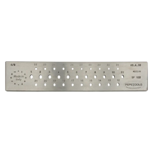

This sounds very interesting. Can you post some photos of the plate (or a link to where to get it) and blocks made using this technique? I found the following on the internet but it's for drawing wire so does not have a cutting edge which makes me wonder how well this particular plate might work.

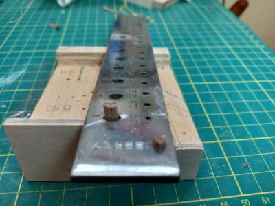

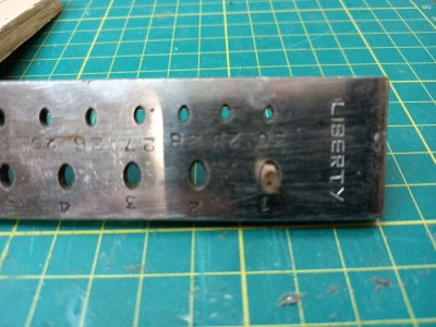

That looks very much like the item I bought. Although it does not have cutting edges as such, if you bash a piece of wood through then the only bit that can get through is the shape of the hole. In the photos below I knocked a piece of 3x4mm walnut through. in the left hand picture I drilled into the end and cut a notch for the strop round the curve. In the right hand picture the hole has been drilled through the curved side and a strop notch cut across the end. (Better?)
Blocks could be sliced off as the blank progressively emerges.
View attachment 494267 View attachment 494273
