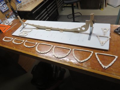

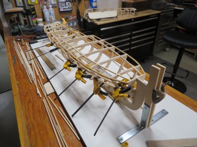

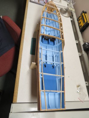

Construction begins with cutting and setting up frames
Balsa bow blocks installed and carved to shape, 1/32 inch bass plywood sheeting covering frames.

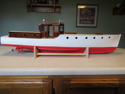

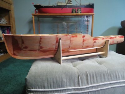

All irregularities in the hull were filled in, and then she was given four coats of finishing resin over 3/4 ounce glass cloth.

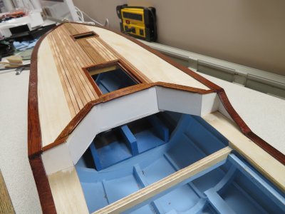

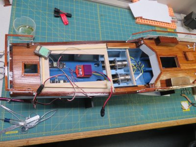

Waterproof the inside of the hull and made arrangements for RC machinery layout.
Laid the sub deck and painted the hull.

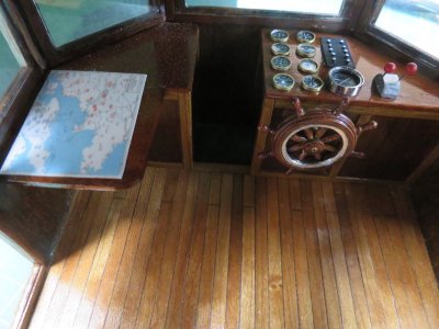

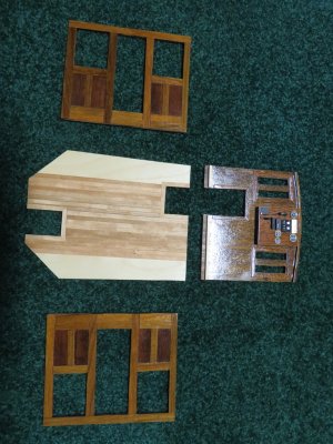

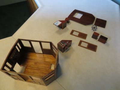

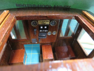

Manufacture pilot house segments and interior layout.

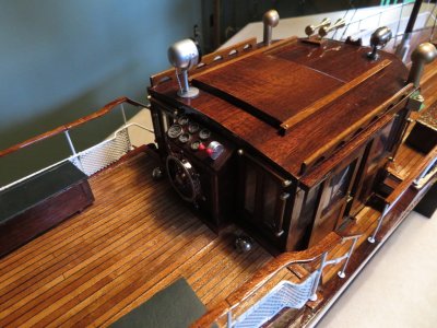

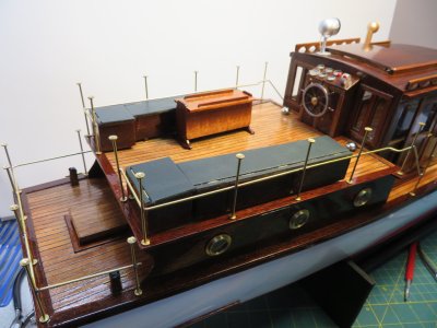

Deck planking and attach cabin structures.

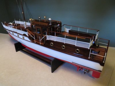

Install RC machinery and build railings.

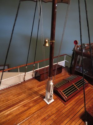

Complete mast work with all electrics and exterior fittings.

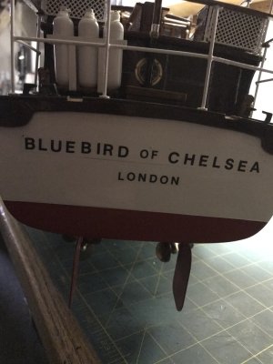

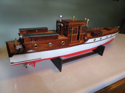

Add the signage with a few other details.

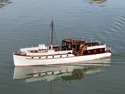

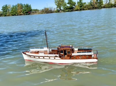

Very successful sea trials with no additional ballast required. September 2024
That looks beautiful. Sorry if I missed it somewhere, but is that all scratchbult?
I don’t do RC boats (yet!), but I’m curious about waterproofing the interior after the exterior is already sealed with resin. Seems like that would trap any moisture in the wood, which can’t be good.
