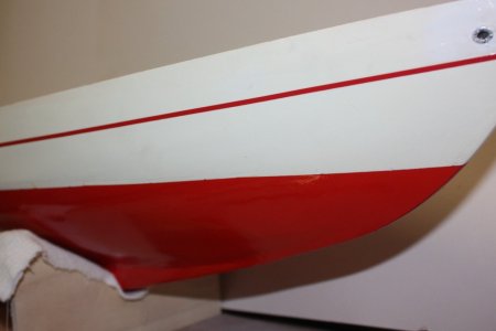

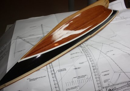

Using various color woods can look beautiful. Swiss pear for the planking below the water line might make a great option to have the reddish bottom rather than paint. If you do paint, remember the white stripe. It is not the easiest thing to paint and some have opted to use pinstriping tape which can look really good.

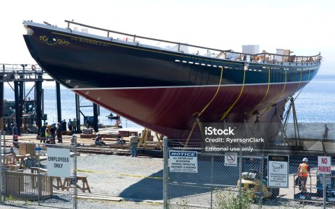

Bluenose II in drydock
Different schooner models showing a stripe using pinstriping tape.
1 -With painted red bottom and red pinstripe tape
2 With Swiss pear planking for the bottom. The hull was coated with a clear matte finish before it was finished to get rid of the glare that is seen in the photo below.
