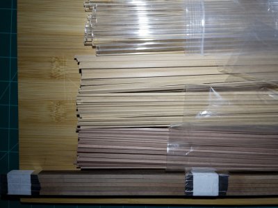

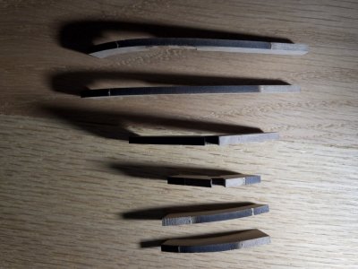

I still like wood, so this will be applied in selected area to keep thing simple. I'm still planning to use the kit beams for the complex area that requires addition of transversal beams but elsewhere... transparent acrylic square rods, cut and shape as replacement. Here what it looks like as a first prototype.
a. cut to length using a small Japanese saw.
b: shape using the current beam as template using heat gun.
c. dry test: as you can see in the last picture the transparency is quite good.
Transparent beam: The kit deck beams are 4mm wide by 3mm depth. However, you can only purchase square acrylic rods. Now, decision... should I use 3mm (smaller in width than the wood beams but require no adjustment in depth) or go with 4mm rods and shave 1mm in a small area in contact with the side support (look easier to shave the wood side support). I'm edging toward the later, even if more work. The reason is that the ship will be seen primary from the top and, thus it may look slightly better.
Will be doing more testing with an area of 3-4 consecutive acrylic beams, both at 3mm and shaved 4mm. Dry testing should help make the final call.
The frames and beams in the YQ kit are (a bit:rolleyes:)oversized. I considered adjusting them, but that would have meant adjusting 'everything'. I don't think the narrower acrylics beams will be a problem. They already look different from the wooden ones anyway. If they are beams with crossbeams resting in them, you could consider a laminate. You do have to make sure the seam is completely sealed so that it is as invisible as possible. I have had good experiences gluing with chloroform; it is water-thin and soaks completely into the seam due to capillary action. However, it is sometimes a problem to get hold of that stuff. The pharmacist in my town believed my model-building story. Looking forward to your next results.

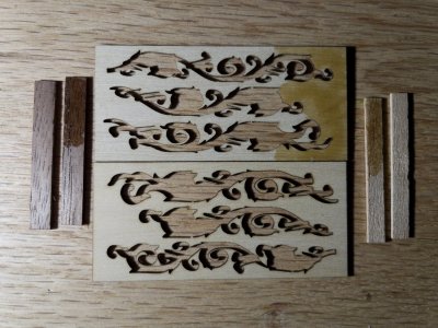

Linseed Oil - Side note: We often WANT to highlight the definition or seam between planks, either for esthetic purposes or to simulate caulking. If you look at the last picture above, you will see two methods:
a) caulking on the ceiling planks was done using a method very often described here: by adding a little carbon to the side of the plank using pencil #2. You will note the very slight "greyish" coloration and not quite uniform (intensity wise).
b) the second method was use for the table (and the wall panel in the back): I just discovered it completely by accident. I guess this is how you gain knowledge. With the table I did NOTHING. The planks are simply hold together by a cross-plank underneath. How does doing nothing still outlined the junction between planks so neatly? The secret is simply by using linseed oil. Linseed oil stain grains and side-cuts darker, thus creating a nice hairline effect of darker color, uniform and not greyish at all. I don't know if you are like me... I like it a lot!

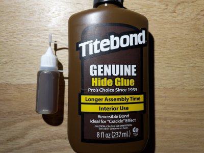

Hide glue - Side note #2: If you go back to the beginning of the log, I mentioned that I switched to "hide glue" for this build. I like its properties and plan on continuing using it. However, there is a side effect I did not anticipate at all - it shrinks and become rock hard while curing. Why does it matter? well... here why.
Sometimes I like building elements such as decks, walls, etc. on the table to be fit later on the ship. Sometimes, it is more accurate and/or more convenient.
HOWEVER, remember my first attempt at the wall gluing planks at the edge only or using a long back cross-plank? The shrinking of hide glue place tension at the junction, which ultimately lead to "curving" of the entire wall. Changing to standard glue solved this for me, and/or (as mentioned here) using an opposite cross-plank on both sides to counterbalance.
This can be an advantage though: the small table and back wall is an example. It worked well with hide glue using a short crossbeam (simply because it is smaller) or counter cross-plank (wall). The advantage is that as the glue shrink and harden it "squeeze the planks together for a nice no-gap fit.

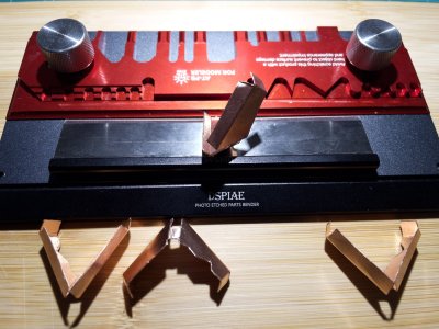

Lastly, I will be using copper bands at the base. This is relatively thick copper (not the tape) formed using small plier. The idea is that it should help with maintenance, strengthen the base and limit rotting. However, I have to reveal a little secret (just between you and me - don't tell anyone): The copper band at the base will act as a sleeve, i.e. not glue to the beam. That way they can slide down to hide any tiny gap with the deck underneath. This way I won't have to drill thru the deck but just leave the beam sit on it.
