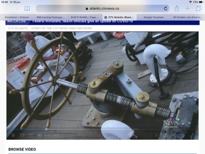

Here are a few links related to the rudder redesigns and steering issues which have gone from manual to hydraulic systems:
and the hydraulic steering system with embedded video and views
https://atlantic.ctvnews.ca/restoration-of-bluenose-ii-reaches-milestone-with-hydraulic-steering-
system-1.2128404https://atlantic.ctvnews.ca/restoration-of-bluenose-ii-reaches-milestone-with-hydraulic-steering-

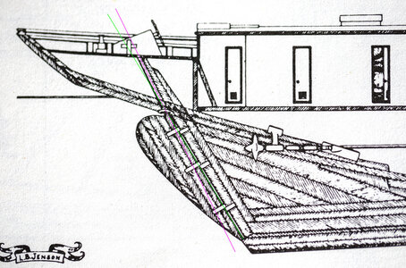

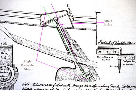

As I showed in my PM to you, here's "the rudder issue" I found in The Saga.
The angle of the rudder stock / the port along the stern post through the hull, is a few degree different than the back side of the keel.
IMHO: the rudder won't steer: twist.
To pictures I took from the drawing, just for the observation and discussion.
Page 53:
Page 22:
A mistake by L.B. Jenson?
Just an observation.
Page 53:
Page 22:

Thanxs for posting, Rich.
Interersting stuff. But when you see the video with all those hydraulic hoses, switchboard etc. Look every old-fashion Sick
In all the drawing, the angle and direction of the rudder, shaft and the shaft-port are all in line. So, strange in The Saga drawings.

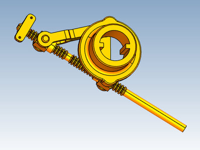

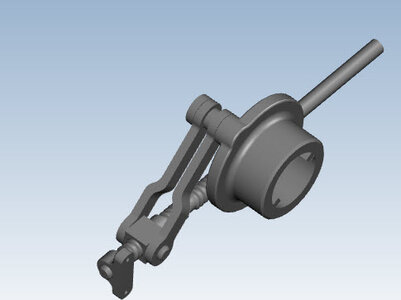

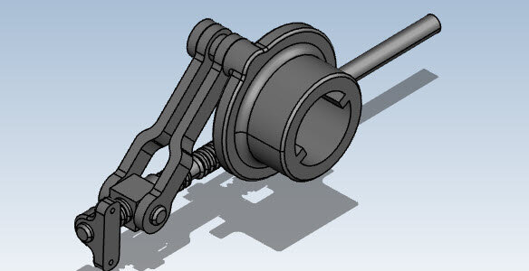

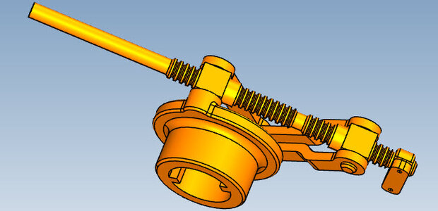

The design from Dean received the steering based on Saga drawing loaded into my 3D CAD Viewer
Planning is that this design will be 3D printed early 2022 together with the Windlass engine
View attachment 275655View attachment 275654
This level of design and production is as far ahead of hand tools as hands off driving for which I don't have a vehicle (or would trust one). These printed parts will make an impressive schooner. Rich (PT-2)
