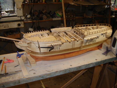

I'm trying to install the boat skids(skid beams) across the waist of the Discovery1789. They are not shown on the drawings I have. Steele says there are six of them on 300 ton sloops. No matter how I arrange them they seem to be in the way of something, entry stairs, holds, fenders come to mind. I've searched through this forum, MSW, and the A's, B's and C's of the WikiCommons ships plans and can't find a picture that might clear things up. Does anyone know off the top of their head where I might find a picture or two that show the skids so I can see how they are laid out? Thanks
I found a couple of build logs for the HMS Sphinx that shows the skid beams. I guess they solved the interference problems by making the beams removeable. These ships were not convenient. It seems that every time they needed something, they had to move two or three things first. I must have taken forever to do anything. Good thing the crews were so big. Apparently later on they made them permanent. No idea how they got anything into the hold.

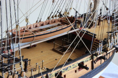

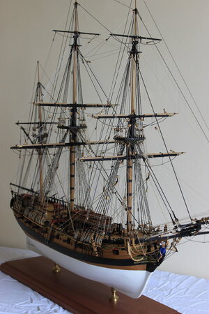

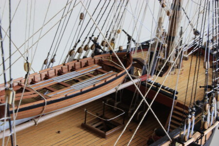

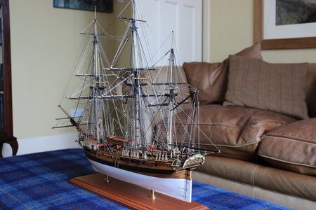

Hi Don,
Here's how i fixed skids (photos attached) to my model of the Swan Class Sloop, HMS Fly. The skids are lashed in a temporary manner to the main mast bits and the fore deck rail.I took this approach as a consequence of some of the excellent photos in R. Gardiner's book, 'The Sailing Frigate'. Hope this helps.
John.

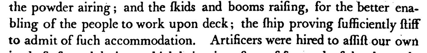

Here is a quote from Capt. George Vancouver's Journal. During their layover at the Cape of Good Hope he mentions raising the skids and booms. Any ideas what booms he may be talking about?
Later in the trip they find that the hold has six feet of water in it. They find that they can't get the chain pumps working because the launch and the cross piece of the bitts are in the way.

So, what I'm wondering about now is, if they had raised the skids, what is the launch doing down on the deck, under the skids?
Hi Don,
The Swan Class Sloop was quite a small ship (6th rate) so i assume space on board was at a premium. I suppose there is always quite a few ways to solve the problems of boat storage, and on these smaller ships, instead of chocks or transverse beam skids, they used detachable longitudinal ones instead (possibly makes movement around the ship less restricted). I used as my sources 'The Anatomy of the ship, Pandora' by J. McKay and R. Gardiner's book, 'The Sailing Frigate' both of which show smaller ships stowing on longitudinal skids. Larger ships with the luxury of more head room and space, as you point out, would often use transverse skids.
