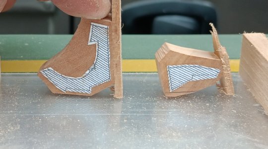

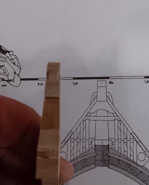

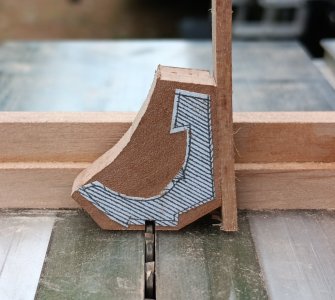

This may help shipyards that have a small table-saw, but no milling machine:
1. Workers cut and brace the piece, so the desired face is parallel to the table:
2. Workers then adjust the blade height to the correct depth:
3. Finally, after multiple passes a smooth flat face is created:

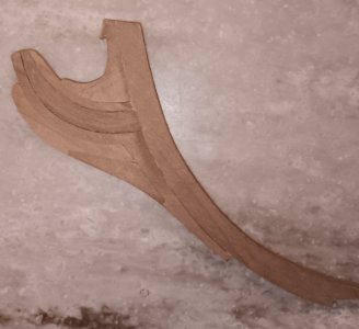

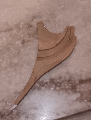

Using the Proxxon and sliding table as a "milling machine", workers were able to fabricate and glue up the Knee of the Head:
You give hope to FET owners everywhere!
My question for the yard boss is what method did the workers use to ensue the face to be milled was parallel to the table?
I have several thin (1-2mm) planks that I stack on top of the piece parallel to the cut line.
The opposite edge of these pieces are then lined up with the blade slot in the sliding table.
Rudimentary but effective...

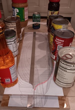

Workers completed the baseplate from which the keel and frames will rise!!!
The baseplate is 0.10" thick plexiglass, laid on a stiff wooden frame.
Two strips of 3/4"W x 1/8"H aluminum will sandwich the keel in place.
Workers also laid out and labeled the centerline of each frame.

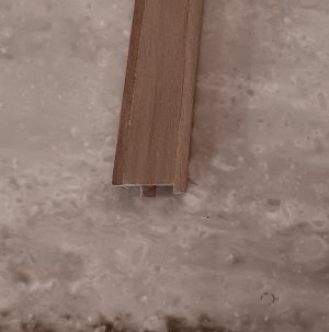

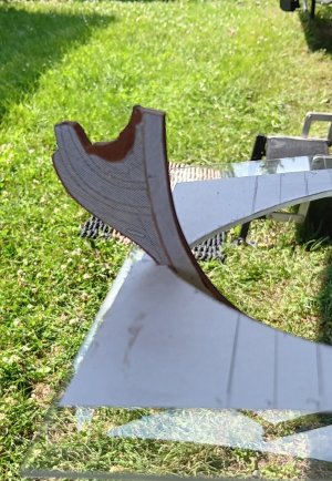

La Salamandre workers (Toulon, FR) are feeling right at home. Yesterday, the shipyard passed into French Speaking Quebec, Canada.

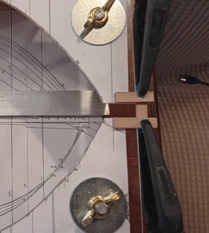

The last several days were spent making the stern rising wood, with a complicated curved scarf joint (photo 1) and a very small mortise/tenon joint on the sternpost (photo 2).
The sternpost assembly is glued, as well as the curved scarf joint. Neither are glued to the keel yet.

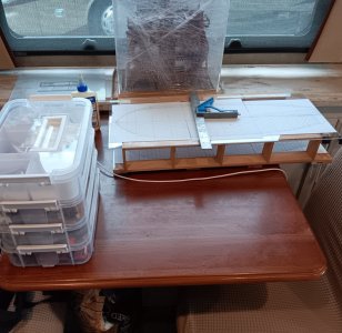

Below are pics of the workspace and view out the workshop window.
Good thing with a TINY workshop....it HAS to stay neat and organized, unlilke the shop at home ROTF ROTF
View attachment 531433View attachment 531434
What a pleasure Brad. Having a forever changing view from your shipyard - stunning. Cheers Grant

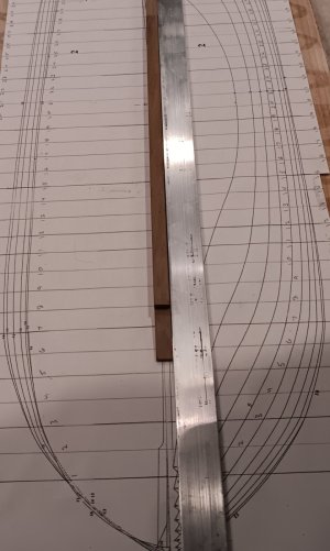

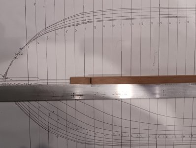

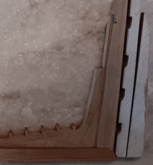

The Montreal shipyard reached two major milestones:
1. The building jig was completed:
Unfortunately, I made the jig too short. The below photo shows the slot in the bow DID NOT take into account Knee of the Head (it was only cut to stem):
To fix this, the jig slot had to be extended (see photo below). Now the Knee of the Head and length of the keel dry fit precisely with the plans!!!
2. The Knee of the Head was completed and tapered to the profile in the plans

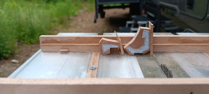

$3 sliding cross-cut table for Proxxon table saw.
I have no milling machine to cut frame slots in the keel.
Shipyard workers quickly realized the Proxxon table saw needs a sliding cross-cut table!!
The provided attachments are not capable of cutting these slots to the required accuracy. This is the "foundation" of the entire model, so accuracy is crucial!!
SO...off to the ACE hardware store in tiny Belfast, Maine, to build one for under $3!
Below are the parts purchased (Less than $3 for the screws):
2ft of scrap hardwood (1.5" x 0.25"). (Free from shipyard scrap pile)
8 x M3 countersink machine screws (Length 12mm / thread diameter 3mm)
6 x M3 countersink machine screws (Length 6mm / thread diameter 3mm)
0.1 inch thick plexiglass 5" x 10" (ACE gave me a 12" x 5" piece from a broken slab for free)
Steps with photos:
1. Cut two strips 0.464" wide x 0.172" thick x 10" long)
2. Cut two strips (0.300" wide x 0.15" thick x 10" long)
3. Slide the wider strip into the travel groove
4. Using instant glue, set the narrower strip on top, apply pressure.
NOTE: continue to move the two pieces back and forth in the groove for two minutes while applying pressure. This will ensure none of the instant glue bonds to the metal of the table saw guides.
5. Pull them from the slots and use a file to remove and glue that may have leaked from the joint.
6. Ensure they slide freely, without binding. If they bind, find the "high" spots and file or sand till they slide smoothly.
Result:
1. Cut the 0.1" plexiglass to 5" x 10". If you have enough cut to 10" x 10" (I didn't).
2. Place the wood runners in the slots. Place 3 strips of paper under the runners, so they stand "slightly proud" of the table.
3. Run instant glue along the top of the runner and press on the plexiglass squarely for two minutes.
SAME NOTE: continue to slide the cross-cut table so no glue can bind to the metal
4. Slide back and forth until it slides freely (file or sand if necessary...mine slid freely at this point).
1. Pre-drill three holes on each guide, using a 3/32 drill bit for the machine screws. I went all the way through (then sanded the bottom).
2. Use a 15/64" drill bit to make the countersink hole for the screw heads.
3. Insert the 3 screws (use 5 if your plexiglass is 10" x 10").
4. Result should look like this
1. Cut two pieces (0.25" x 0.65" x 10") for the bottom "wood rest" and "top brace"
2. Using jigs/stops/clamps/etc, PRACTICE setting the bottom "wood rest" EXACTLY PERPENDICULAR (you only get one chance).
3. Use instant glue to set the bottom "wood rest"
4. Use instant glue to set the "top brace". This is not critical to make exactly perpendicular.
5. Use the eight 12mm M3 screws to reinforce these glued joints. Ensure these are countersunk, so they do not drag/scrape your table.
See below:
1. Run the sliding cross-cut table through a blade raised 0.50" (I felt this was adequate for 1/4" ship modeling). This will give you 0.40", available for cross-cuts.
2. Do a test and experiment with blade height adjustments/lock stops/etc
3. You are now ready to begin cutting accurate and repeatable frame slots in your keel.
Shipyard will start milling the frame slots in the keel soon!
