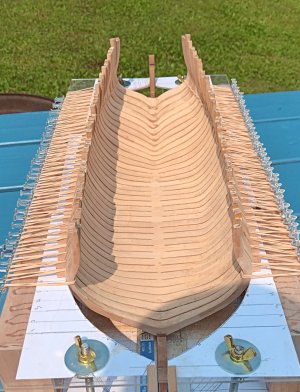

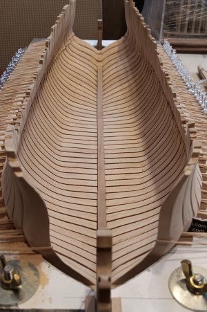

The shipyard moved across Ontario on the Trans-Canadian Highway. The frames from 6, to the stern are complete.
The wide flat-bottomed area for the mortars is beginning to take shape!
The last forward 5 frames should be complete by the time the shipyard crosses into the UP of Michigan!
Everything is dry fit and some rough sanding was done to the interior lines.

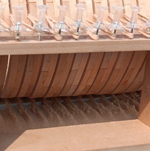

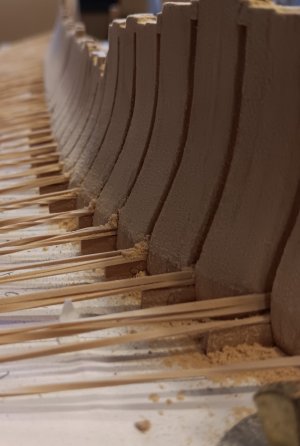

The familiar piles of sawdust began to appear under the space between frames.

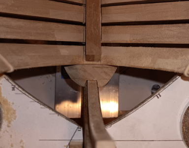

The last stern frame is very unique and took a full day to complete.

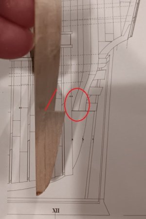

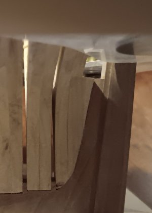

1. The bottom half of the frame was cut away. An extra thick solid block was then inserted. It was rough tapered using an oscillating spindle sander:
2. The thick solid block then had to be sanded to mate with the curved keel piece:
3. Finally, two complex, curved, stern cant frames have to be cut. They will extend into the frame and nest on the top of the flat ledge. This intersection will be very interesting and tricky to construct!

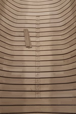

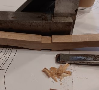

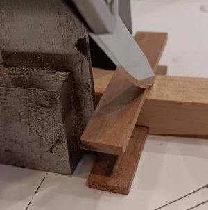

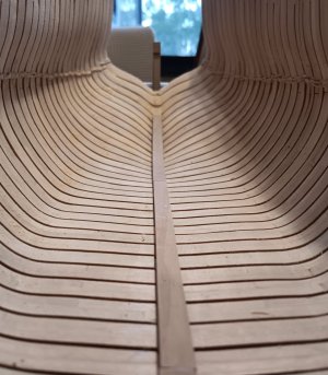

Workers did manage to begin cutting notches in the top of the frames for the keelson to fit securely in. This was accurately accomplished using a scalpel blade, two blanks (the width of the keelson) and a sharp chisel. See photos below:
1. The blanks were squared up parallel to the keel and the scalpel blade scribed a reference line:

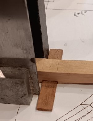

2 . The frame was reversed and a second line was scribed:
3. The chisel was then used to cut to the keelson notch to the correct depth, with the resulting curled shavings:

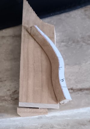

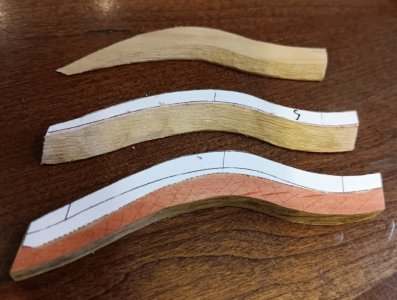

4. After reaching Wisconsin, workers completed 16 of 42 notches! As the stern/bow begin to curve up, extra measurements and care will be needed to get this rising wood correct. Templates have been made to help check this curve:

Good morning Brad. That is quite the job cutting the keelson notches by hand. I am impressed, my notches would look more like your travels crisscrossing Canada and US;).

Nice clean handmade notches and travel pictures, Brad.
