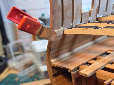

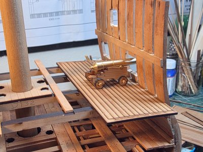

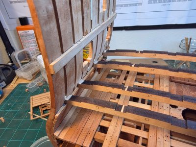

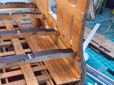

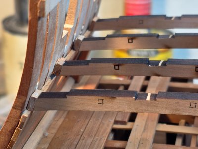

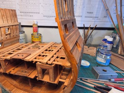

Brief update:

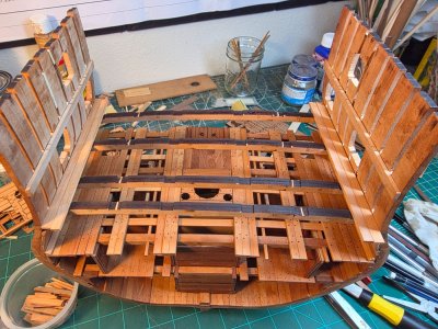

I decided to check the beams of the following 2 decks and found exactly the same issue as @neptune . The beams are short in length.
The issue and @neptune solution are very well documented on his thread. I do not need to post the same images. Go to page 6 post 101 of his thread. Link pasted below.
Post in thread 'USS BONHOMME RICHARD - POF - Cross Section in Cherry - 1:48 - by neptune,' https://shipsofscale.com/sosforums/...ion-in-cherry-1-48-by-neptune.3773/post-77055
My solution was diferent. I added exactly the same piece of wood at each side of each beam. Then small adjustments and issue solved.
I also tested the deck position , placing my testing BR cannon, and looks fine.
The images show the deck in place, but nothing has been glued.

I know it might be tedious, but I think I would get the "sprue" for these timbers and take some from each end, remove the char and use those to fill the gap. That way you could match the grain of the wood better.
I though about it. All those beams will be covered by the deck planks and anybody will ever put his head to look upside down the beams, so I took the easy way to solve a kit development issue. The next deck has the same issue. I need to see how visual is that deck.
Thank you !!!!!

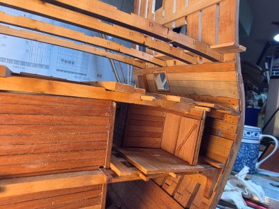

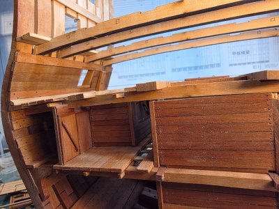

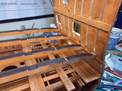

Rob, the pictures I posted still needed a little of sanding on those extensions. For you to see how it will look, I sanded them, added a few planks, took images from above and below. In the last one, you can see that another plank will cover the sides of the extensión (i still need to cut that plank). Also on the most visual part goes the knees.
Bottom line, at the end, it is almost all hidden. Now you see why I took the easy path.
Cheers
Daniel

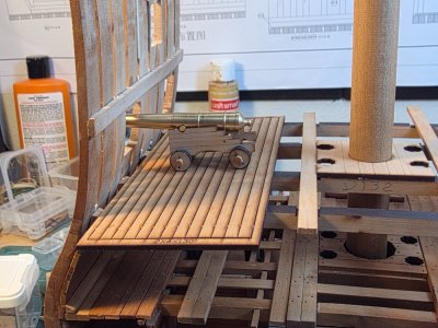

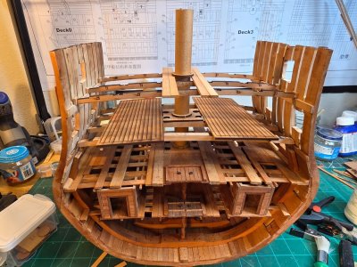

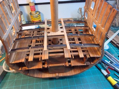

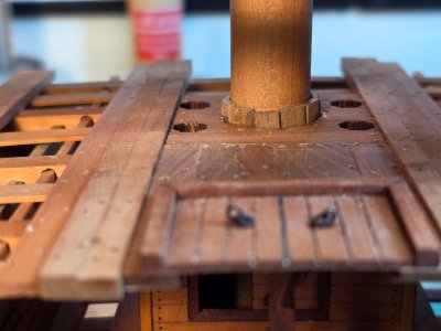

Hi all

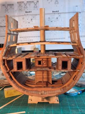

I would like to start with the hull planking, but for that I need to have the gun ports finished and before that I need to check that there following 2 decks are in the correct position. Because all of that I partially assemble deck #1 (images attached on previous posting with the cannon and mast.
Now I partially assemble deck #0 (these deck numbers are the ones provided in the kit) to check also its position and the mast fitting. Concerning the mast, i added the wood pieces uses on deck #2 to center the mast. For that i used 4x1,5 mm sapele wood. The wood provided on the kit was 2mm thick and didn't fit.
Moreover, I had to extend Deck#0 beams as I did on deck #2
Nothing is glued, just placed to visualize that all is fitting as expected. And still there is needed a good sanding and improvement of the parts.
Sorry guys, for the sanding dirt seen on the zoomed mast image.
Cheers
Daniel

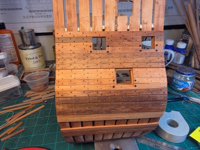

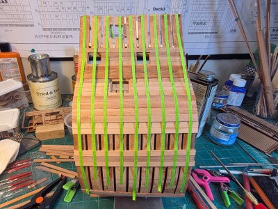

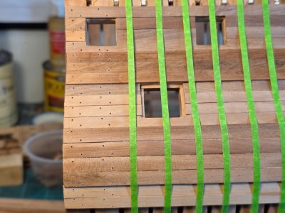

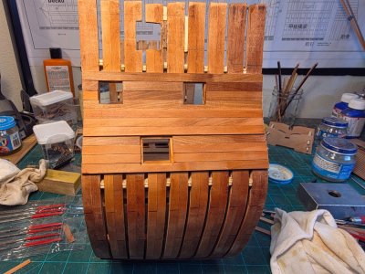

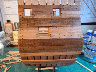

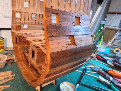

Started the hull planking after finishing the gun ports of the next deck I will built. It is easy to manipulate the kit at this stage during the hull planking.
It is not stained, just some mineral spirits to show the wood beauty.
Showing one side now. The other is on the works. Plus the hull bottom, that never ever anyone will be looking at :-) 20250921_173507.jpg20250927_195100.jpg20250927_195123.jpg
Cheers
Daniel
Very nice, Daniel! The wood tones are going to be pretty incredible on this model!
Thank you Paul !!! And thank you all, for all the likes.

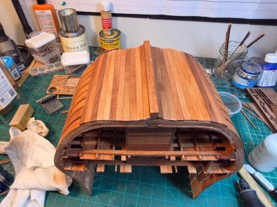

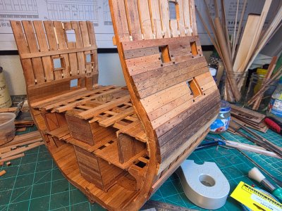

Hull planking on one side is almost finished. Still need to plank the upper part. But that has to wait until I cut the ship shape there. Now the same on the other side.
Cheers !!
Daniel

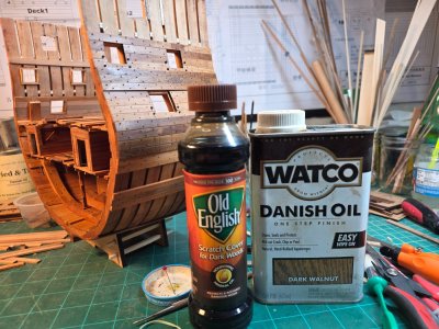

I forgot to say that the pearwood at the whale and at the rubbing strakes (is that the correct name for the 3 thick woods above the whale ?) I used 3 coats of Danish oil Dark Walnut and 3 coats of Old English for Dark Woods. On top of that, I selected from my Swiss Pear wood stash a more darker wood than the provided by the kit. I did cut planks of 3x6 (rubbing strakes) and 3x7 mm (Whale). Plus I did a few 2x6 mm for the hull planking and mixed some with the kit ones. Mine are the darker ones.
