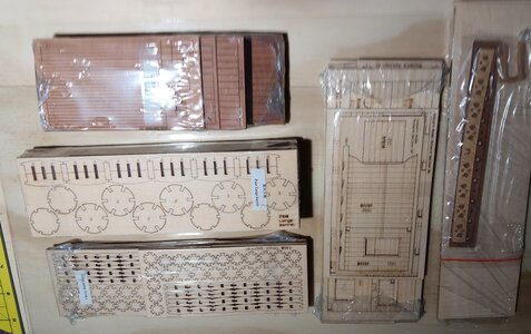

DHL delivery from China Today!!! I'll post a few pictures from the unboxing below. Next post, I'll discuss my thoughts on making a duplicate with a bunch of Alder I have from a recent project.
First impressions:
1. Kit arrived via DHL in Eight days! It was well packed and looked pristine when I removed the exterior wrapping (photo 1).

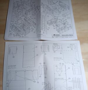

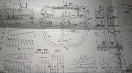

2. There is a very large plan sheet (photo 2) is just 1/4 of the sheet. Printing is clear and precise. Translations from Chinese to English look adequate.
3. There is also a set of smaller drawings on a dozen or so sheets that show specific instructions and details (photo 3). Again, clear images and translations look adequate.

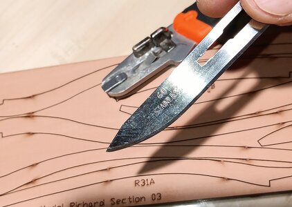

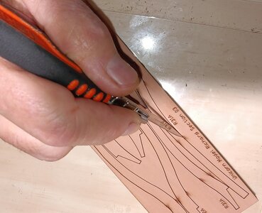

Below is short description of how to get the frame sections out of the Pear Wood blanks.
1. Use a surgical scalpels, which I buy in boxes of 100... see link: https://www.amazon.com/gp/product/B00D79EODK/ref=ppx_yo_dt_b_search_asin_title?ie=UTF8&psc=1 See phot 1.
2. In the second picture, you can see the blade slicing deeper in the two tiny areas where the laser did not cut the wood.
3. Next, a Japanese flush cut, pull saw, see link, (https://www.amazon.com/gp/product/B07T9K59D1/ref=ppx_yo_dt_b_search_asin_title?ie=UTF8&psc=1)
is used to cut the excess wood to a fraction of a mm of the frame.

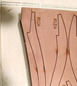

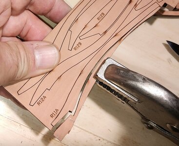

4. After using the surgical blade, to loosen the wood grain at the two tiny areas the lasers did not cut through, I use a pair of vice grips to gently rock the wood back and forth over the weakened joint (photo 4).
5. The two joints where the laser did not cut through leaves a slight bump or elevated area. They are the light-colored areas. I use a file or sandpaper to remove some of the black char and those elevated areas where the laser did not cut through (photo 5).
6. Finally, the joint is dry fitted, to ensure it is nearly invisible. (photo 6)
Next step is to do this to all the joints, then glue them over a paper copy of the frame structure. This will produce a 1/2 frame. Two of these 1/2 frames will be glued together on a glass plate to ensure it is perfectly flat.

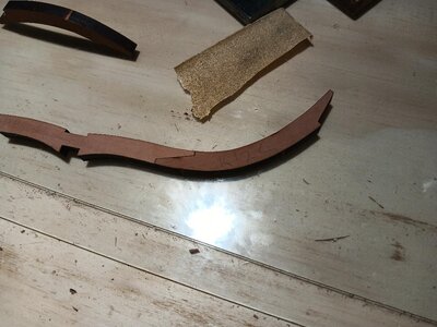

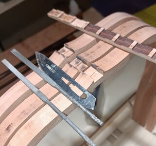

Made the first frame. I'll narrate the process, using the pictures below for visual aids.
Pictures 1&2 below. I used the steel anvil/bench block ($15 on Amazon) to help sand the joints to remove the relatively thick black char left from the laser cutting process. I used 220 and 180 grit sandpaper (second photo).
Picture 3 shows the removal of the thick black char. One gripe is that ZHL frequently places the place where the laser "skips burning" on the joint. I'd say this happens 20% of the time and it leave an area that is difficult to sand completely even for the joint (see red arrow) below. I think ZHL/Unicorn could easily program the burn to not skip on the joints!
Picture 4 shows the two layers being glued on top of each other. I start at the keel and use a small "jig" of walnut that is cut to the width of the keel to ensure the two keel slots are perfectly aligned.

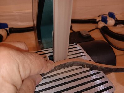

Picture 5&6 show the char on the outside of the frame being removed, after the two frame layers dry overnight. For the convex curves I use a $40 belt sander from Amazon, with 220 grit. For the interior concave curves, I use an oscillating drum sander I've had for year, with a 180 grit paper.
Picture 7 shows the first completed frame.
One down and 8 to go!! Hope this is helpful to anyone doing this build in the future. Once these are complete, I'll do the same frames using the Harold Hahn method, using leftover alder.

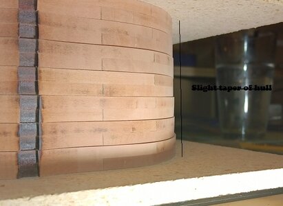

A few steps forward. 7 of 9 frames glued up plus: 1) I got a little start on the keel and 2) made a minor modification to the task light in my shop. Pics and detailed description below.
1. I made a jig to make the rabbet in the keel and used my thickness sander to take off tiny amounts. Photo below:
2, I slowly increased the rabbet until I had the thickness of the planking and then I used a surgical blade as a scraper to smooth out and polish the rabbet edge.
3. Process was repeated on the other side, with the result shown below.
I took a photo of the 7 frames I completed. With the light and stacked the way they should lay, one can see the slight taper from the first frame as the hull slowly tapers toward the stern.

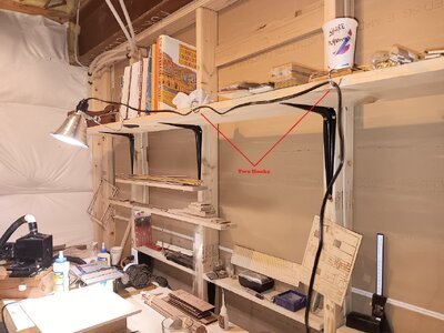

Finally, I added two small hooks on the shelf above the workbench. This allows me to move the $10 task light to any spot on the shelf, without the wire hanging down and getting in the way...simple, cheap and effective.

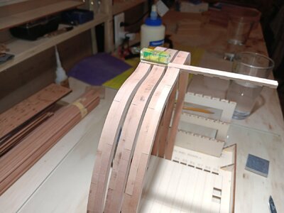

Constructed the frame jig and have begun fitting the frames into the jig provided. It takes a lot of minor adjusting and very detailed filing to remove the char. I also found the depth of each slot needs to be adjusted slightly, to ensure the taper of each frame ends flush with the rabbet on the keel.
1. Making the jig and ensuring all joints are 90 degrees. All joints and slots fit tight and snug.20240206_102848.jpg
3. Some of the tools I used. The first three frames have the char removed.
4. The next two show how they are fitting with respect to the keel, a bubble level and the rabbet. Nothing will be glued for a long time as I fiddle and fine tune each joint. So far, I'm impressed how tight the joints are. This should make everything very solid once the keel is glued and spacers are added. Then the job of sanding and fairing the frames will begin.

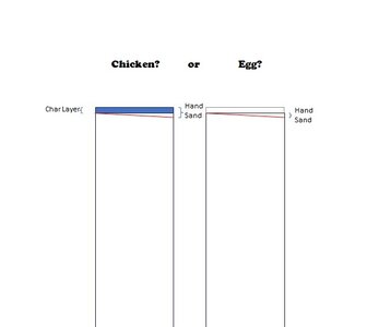

Please wait with the final char removal until you have installed and fixed all of the frames. they are slightly different, so when you have installed them you can snad a smooth hull form and remove in the same working step the char....... This is how I did it on my section
Uwe,
Too late, I have already removed the char:(. I'm working on aligning the depth of the slots for the keel and keelson so the thickness from bottom of keel to top of keelson is the same at all frames (tedious work). This should make it easier to fabricate Limber Strakes, since they are not provided in the kit.
I can see why leaving the char would help to visually fair the frames....so your method may be easier visually.
I don't think it is a mistake to remove the char first, is it? I believe your method has more control, with the delicate touch of the hand/eye but each will produce the same result. Is this a Chicken or Egg question? Please let me know if I'm missing something! See photo below:
Everything will be fine, when you remove only the char on the single frames - and final sanding afterwards
It could be only problematic removing on single frames partly more ...... everything fine with your work - the result is looking very good
Test fit of the frames, keel and keelson in the jig provided with the kit. Everything fits snug. Only friction is holding the parts together in the photo and is feels very solid, without any glue!
As I did this test fit, I planned the sequence to glue the parts together. I anticipate several days of silence while I glue and then sand/fair the frames. Time consuming and critical part of the build!
