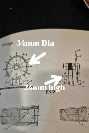

I am looking for information on how I could make these items without 3d printing help> Has anyone ever made a wheel that looks authentic around the sizes I give in the photo print below?
If so, please tell me how you went about making them.
I also see the Helm Wheel has 12 handles on it, as depicted in this photo supplied.Helms Wheel and Platform .jpg
I have looked online, but nothing looks close. Also, I have not bothered to look for them online in the US, as the postage fees are astronomical! Australian Hobby mob have similar, but they don't answer my emails. I have tried to contact Modellers Central in Australia, but have received no answer at all.
BTW, the stumbling block is the width of the wheel to scale, which is only 2 mm wide! The brass rod I have is only 1/16th of an inch
Looking forward to the help I need to do what I want to do and try to make them myself that look authentic and accurate.

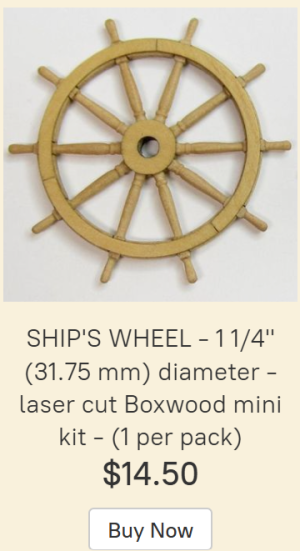

This is available at Syren Ship Model Company at:
Syren wheel
I doubt anyone could tell the 2 mm difference. :) And it's only 10 handles.
I've seen one of these in person and they are quite nice.
Hopefully due to the small size, the shipping wouldn't be too bad to get it to you.
Note: It is a "mini kit" and does have to be built. :)
It is just the wheel and you would still need to fabricate the supports.
Syren wheel
Hi Jeff, and what about the Platform for the Steering helm? What are your thoughts on that? Also would be appreciated.
