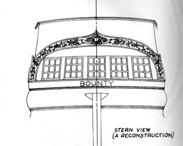

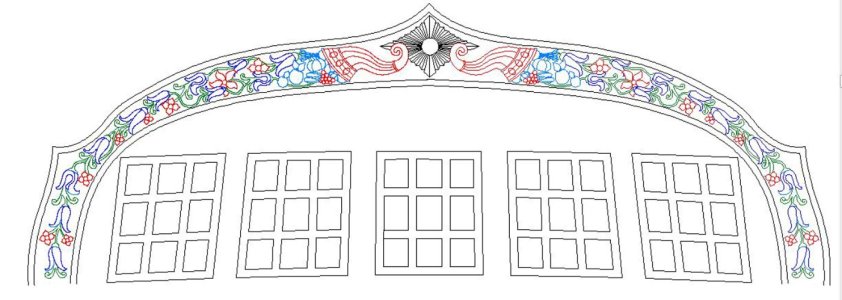

it comes down to the process of going from raster to vector the goal here is to take the Bounty drawing by Harold Hahn and create a printable 3D file of the stern.
Raster images are made up of a bunch of tiny pixels and are great photographs or highly detailed artwork. Vector images are made from mathematical paths and are ideal for drawings or computer-generated images

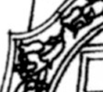

a raster image
a vector file looks like this
lets zoom in this is what you see

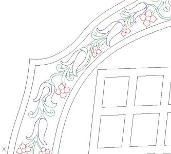

this is a vector image and no matter how far i zoon in it is still sharp lines which can now be used as a tool path.
back in the day the width of a fine sharp pencil was the limit in CAD i can split that a dozen times.

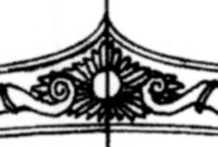

note here at the corners of the stern on Hahn's drawings, notice something missing?
i see large scrolls who is right? and if this is going to be a file for 3D printing Hahn's bounty do i add the scrolls or stay true to the Harold Hahn plans?
